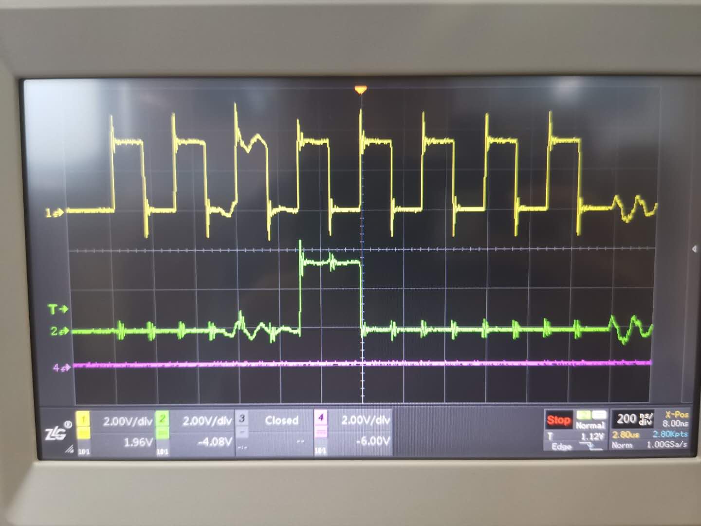

Customer catch the air wireless data package while their CC2520 network system under communication, and found sometime a totally same package will continue re-send many times (> 10 times).  We put a GPIO toggle just in the send data function code but do not observe the GPIO toggle, so we think the re-send behavior should not caused by send function called repeatedly.
May we get your help advice if the re-send behavior is normal? I attach the air capture data package file in here for reference. It is used by packet sniffer.

  • Can you please provide more information about the system, including host processor, SPI configuration/timing, and instruction/command format?  Some oscilloscope or logic analyzer screenshots may be helpful.  Are the CC2520 Software Examples referenced?

    The host is MSP430F5659 connected with CC2520 through SPI. According the SPI waveform capture as below, we think the SPI configuration should be correct and signal is clearly. Actually the repeat behavior is not happen often, but usually easy captured the repeat package when the wireless communication become heavy. So we suspect the issue caused by message conflicting or ack missing, do you think the psd file in my 1st post for repeat frame content can help for issue investigation?
  • Hi Terry,
    As best I can tell, these packets are re-transmitted because no MAC ACK is returned by the destination device.  It's difficult to tell as all packets appear to be the exact same and no NWK keys are provided.  Is Zigbee or 15.4 protocol being evaluated?
    Ryan
  • Hi Ryan
    It it customer own protocol modified base on zigbee.  We find the re-transmitted issue seem easy to happen while the transmit data exist 0x43, which is same value with STXON command. So we suspect SPI maybe wrong identify the payload data 0x43 to be command STXON, so that re-transmit the FIFO data. We will try continue investigate more for SPI behavior. Thank you advice,
