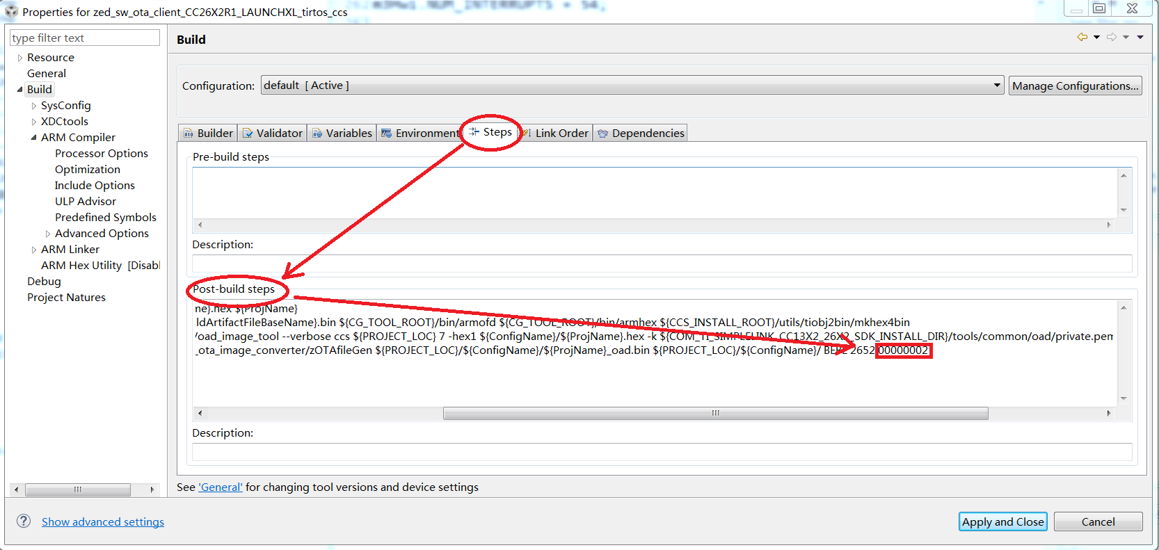

3.After the two boards were loaded, powered on again and worked normally, the UART printed normally. I modified the version number of the
zed_sw_ota_client_CC26X2R1_LAUNCHXL_tirtos_ccs project in CCS, and changed it to 2, as shown in the following figure, and recompiled to get the file: BEBE-2652-00000002.zigbee as OTA image.

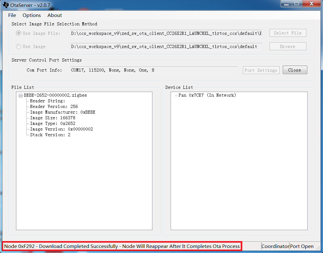

4.I use OtaServer software to connect to the board as a server,as shown below,client joined the PAN 0x7CE7,I right clicked the node 0xF292,and select Image Notify,after a while,the image download began.
After the image transmission finished,as shown below.It saied downloaded completed successfully,node will reappear after it completes OTA process.

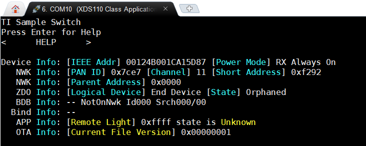

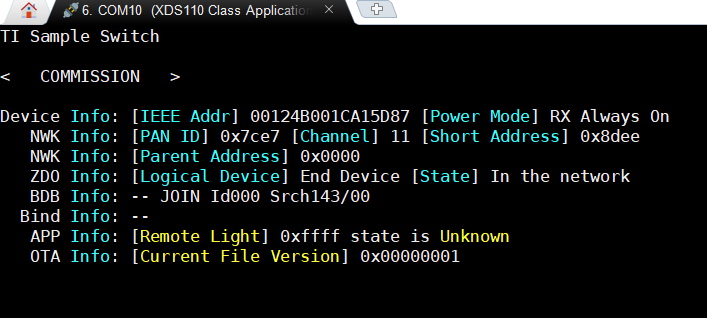

5.For the client, when the client is connected to the server, the UART printed as follows.
After the image transmission has completed, waited for a while, the UART printed as follows.
My problem is,after the image transmission is completed, the client does not reconnect to the server,UART printed that current file version is still 1 not the 2 I have changed.Client OTA upgrade was not successful.
