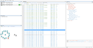

I'm using the latest version of Z-STACK-HOME 1.2.2a ZNP on CC2530 (default version modified with this path file). I faced a new issue when I use ZNP in a large network with more than 10 routers. the ZNP stops working suddenly and doesn't respond to any serial command. I should sometimes reset it with reset pin and a few times I should reflash it.
as it doesn't get debug log I can't find why it crashes. can you help me?
EDIT:
as seen above, suddenly the ZNP stops working since the highlighted line.
in another test, the ZNP continues with an unknown encryption key!
(filtered data: just data with source address: 0x00)
  • You can contact or the Zigbee2MQTT forum for specific questions regarding the modified firmware.  You could also actively debug the CC2530 to pause during the crash state and attempt to determine the reason through the call stack.  Restarting with a faulty NWK key or needing to reflash the device indicates corruption of the NV memory.  You should determine whether the CC2530 is properly powered and ensure that flash writes do not occur below 2.2 V.  Can this be replicated with fewer joining ZRs or is it always the exact same number?  This could help determine what needs to change in your firmware.

    I have done more tests and found a specific way leading to the cc2530 crash.
    In a large network with about 20 routers, I turned off and on 13 routers simultaneously. after turning it on, the routers start sending "route request" command to cc2530 and it crashes.
    can you prefer how I change the value of the above parameter to prevent the crash?
    in the below log, the highlight blue message is when I turned on 13 routers and they started to send "route request" and cc2520 crashed. the mac address mentioned in below messages is my cc2530 mac address.
    I repeated the test and cc2530 crashed again.
  • You should follow the suggestions from the Known Issues and Fixes E2E post which can apply to Z-Stack HA 1.2.2a as well.  For example, stagger device join start times so that the ZC is not overwhelmed with Link Status and Route/Address Request messages.
