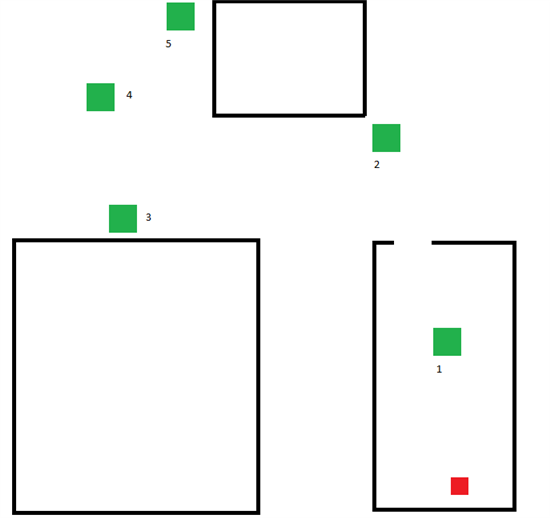

We are in the process of developing a system that uses Zigbee technology to send information. The system will consist of around 200 routers sending data back to a coordinator. To help with development we purchased several CC2530ZNP mini dev kits in order to create a smaller version of our system (6 routers). The MSP430 contains our own custom firmware (based on your examples).
Below is a picture of our test setup.
NOTE: The distance between two routers is no more than 5 meters.
Key
Black line = Walls
Red square = Coordinator
Green square = Router
All the routers seem to connect to the network ok. However only routers 1 and 2 always send their data successfully, 3 most of the time, 4 less frequently and 5 hardly ever.
I determine whether or not the data was sent by the AF_DATA_CONFIRM command, status byte equals 0.
Is there any reason why the further I get away from the coordinator the less likely messages are to be sent? I could understand if they were being sent DIRECTLY to the coordinator but thats not how a Zigbee network works. The routers should be sending messages via each other e.g. if router 5 wants to send a mesaage to the coordinator it does so via routers 4, 3, 2 and 1.
Also whats the maximum distance between devices?
The documentation for AF_DATA_CONFIRM does not mention what a status of 0xCD is, what is it?
  • Hi Richard,
    1. You can place all the routers inside the room with coordinator
      and see if the obstacles is the issue here.
      It is very unlikely, but it can happen that all the routers connected to the coordinator,
      and therefore sends its messages directly to the it.
      Please, provide more information about the way you are registering the routers in
      ZigBee network and by the way, what is the version of Zstack you are running your
      application on?
    2. Regarding the "maximum distance" between the devices, read the following post,
      it might provide you with helpful information.
    3. In the "CC2530ZNP Interface Specification" document, go to page 117, there is a
      list of parameters for status return values: 0xCD means "ZNwkNoRoute".

    Can you please elaborate on the network topology? Did all the routers join the network, having the coordinator as the parent? Had all the routers been at the locations by the time they joined the network, or were they moved to the current places after they all joined the network?
    I ran a couple of tests this morning and found that it seemed a lot more reliable when I let the routers join the network first and then moved them into position. Its hard for me to tell if the coordinator is the parent for all the routers as I only have serial debugging for two (those both are), the rest are battery powered and only have LEDS for debugging. If I move the routers into position first and then turned them on one by one (nearest first) I experience similar problems as those mentioned in my first post.

  • Hello Richard,
    ZNP Mini kit have range greater than 5 meter and so range limitation does not seem to be the issue.But when you are testing how high are the router units above the ground, what is the surrounding of the kits. Below are few suggestions:
    1. From your 1st post it looks like upto 2nd node communication is working properly, when you bring in the 3rd node problem starts, did you try bringing the 3rd node closer to the 2nd node and tried if that improved the network operation.

  • Hello Suyash
    In answers to your questions:
    1) The coordinator and routers 1 and 2 are about 1 metre off the floor, but routers 3 / 4 / 5 are on the floor (see diagram in original post).

  • Hello Richard,
    Height of an antenna above the ground has an affect on its range, I will recommend you to move the units 3, 4 and 5 about 1 meter high and see the results. Thanks
    Suyash Jain
  • Suyash makes a very important point - concrete is an incredible RF black hole, most especially on those poor little PCB antennas!  Even just having a nice omni would help get away from that damper effect. Another customer made the same mistake but in the other direction by mounting directly to the concrete ceilings of a building - it "looks" like that would give great range, but the concrete sucks the life out of the low-power RF signal.
  • I've programmed the new firmware onto the CC2530 and can now communicate with it via SPI. Not given it a thorough test yet but a router with this firmware connects to my Zigbee network.
    Placed the routers on the floor 1 metre off the ground and that appears to have improved things a bit.
