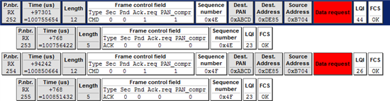

now i monitor the air data
In p.nbr=252  smoke sensor(0xB704) send its parent(0xde85) a data request
In p.nbr=253  parent(0xde85) tell child(0xB704) I don’t have a data for you,because pnd=0 in frame control fieldèthat is ok

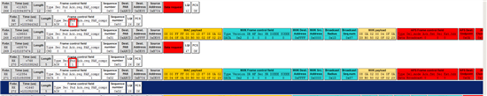

In p.nbr=270 parent(0xde85) tell child(0xB704) I have a data for you,because pnd=1in frame control field
In p.nbr=271 parent(0xde85) give the data to child(0xB704)

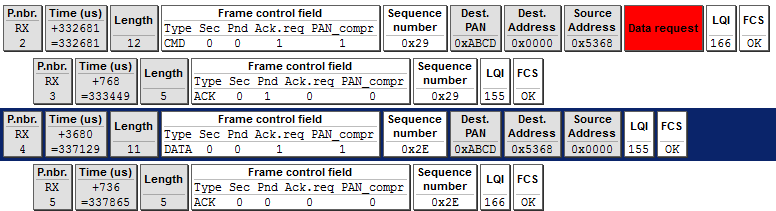

In other test ,the short address changed ,smoke sensor(0x5368),its parent changed to 0x0000
Now In p.nbr=3 parent(0x0000) have the data for child(0x5368)
But In p.nbr=3 parent(0x0000) send nothing to child(0x5368)èoh my god~~èso the child(smoke sensor) always send “I fond somke”

  •  this is a explain about  pnd bit in MAC frame control field
    7.2.1.1.3 Frame pending subfield
    The frame pending subfield is 1 bit in length and shall be set to 1 if the device sending the frame has
    additional data to send to the recipient following the current transfer. If more data are pending, the recipient
    shall retrieve them by sending another data request command to the device. If the device sending the frame
    does not have any more data for the recipient, this subfield shall be set to 0.
    The frame pending subfield shall be used only in frames transmitted either during the CAP by devices
    operating on a beacon-enabled PAN or at any time by devices operating on a nonbeacon-enabled PAN.
