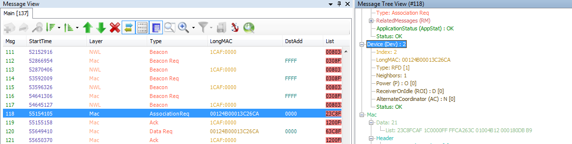

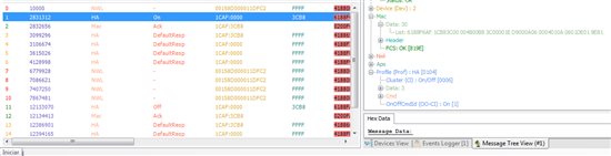

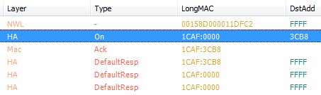

  • Sample switch shows you how to send on/off command. If you want to receive on/off command, you should try sample light project.
  • Hi Mr Yikai Chen. Thanks a lot for your answer. I change my test from SampleSW to SampleLight and i saw the same behavior. The PermitJoinReq was reached zclSampleLight_event_loop on a  afIncomingMSGPacket_t *MSGpkt.
    I would like that my SampleLight will reach the ZCL_INCOMING_MSG and after it i can wrote the CallBack procedure and the device (samplelight) can send the HA DefaultResp.
    I will try to explain you more about my test environment:
    Zstack: ZStack-CC2530-2.4.0-1.4.0
    The commercial Gateway just working with Sample light switch as a RouterEB, when i using EndDeviceEB the gateway didnt send the CMD ON to the SampleLight device. Maybe i can change any configuration to working
    As you see above the Cluster ID is On/Off (0x006), because it i was change the SimpleDescriptor and General Basic Cluster Attributes from ZCL_CLUSTER_ID_GEN_BASIC to ZCL_CLUSTER_ID_GEN_ON_OFF, according the ZCL CMD ON/OFF sent by Commercial Gateway.
    You can see my project files attached on this post. Please, would you can help me to understanding, why the CMD on was not reach on the zclSampleLight_event_loop in the ZCL_INCOMIG MSG, below:

  • Hi Mr  Yikai, firstly i would like to say thanks a lot for your assistance.
    As you suggest to me i was check the DstAdd and DEP and  was compare, my device, with a Device Light Switch from a same gateway vendor. As i explain it for you below:
    Device 1 (same vendor) - Light Switch:
    MAC layer DstAdd: 3CB8 (you can see on the PIC below):
    HA laye DEP:10
    Device 2 (My with a sample Light Code):
    MAC Layer DstAdd: 797F
    HA laye DEP:10
    I was see that has a little bit difference, between two devices, during Join Procedure, on the AssociationReq sent from the Device (Router) to Commercial Gateway, i was compare the two devices,  and see that the device types is totally different the 1st is FFD and 2st is RFD , but i think that it is not relevant. You can see the differences below:
    Type: FFD
    Type: RFD
    Thanks a lot.
    BR
    Alex

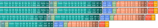

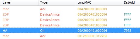

  • Before ZC sends command to your sample light, ZC need to know the short address of your sample light. So, the problem might be on ZC. Do you use packet sniffer to check the destination address of on/off command is the address of your sample light?
  • Hi Mr Yikai. Thanks a lot!
    I including here the sniffer from ZED (Commercial) and mine ZED (samplelight) and seem to have a little differences on ZCL-CMD On/off sent by ZC, but the DstAdd is correct!
    Commercial ZED associated on ZC and received CMD-On/Off (NWK-Layer):
    DstAdd: 3CB8
    Mime ZED associated on ZC and received CMD-On/Off (NWK-Layer):
    DstAdd: 7973
    I was observe differences also in long logMAC, as you can see bellow:
    Commercial ZED associated on ZC - LOGMAC
    LongMAC: 1CAF:0000
    Mine ZED associated on ZC - LOGMAC
    LongMAC: 00A200040100004
  • The original endpoint of Sample light is 13.
    #define SAMPLELIGHT_ENDPOINT            13
    Please check if the on/off command send to endpoint 13. I suspect your the ZC sends on/off command to endpoint 10 only. If so, you need to change "#define SAMPLELIGHT_ENDPOINT            13" to "#define SAMPLELIGHT_ENDPOINT            10".

  • HI Mr Yikai. Would you can help me, please!
    The commercial Gateway didn't recognized the DefaultResp sent from my ZED (SampleLight). I was analyze the DefaultResp and compared with a Commercial ZED and saw that:
    On the NWK layer:
    The DestAddress (Destination Address) is: 0000, totally different that i saw on the Commercial ZED:
    The DestAddress (Destination Address) is: FFFC.
    Did you can advise me, please, how to I can change the NWK DestAddress to FFFC on my Device (SampleLight)?
    BR
    ALEX
  • The address 0xFFFC is used to send to all routers and the coordinator. Why do you think The commercial Gateway didn't recognized the DefaultResp sent from your ZED?
  • Hi Mr Yikai.
    I understand after your explanation. After it i observed the differences between commercial ZED and Mine and see that on the DefaultResp (from Commercail ZED) have a Payload (APS Payload) as you can see bellow:
    Would you give me direction, please, to include APS Payload on the DefaultResp?
    I was observed also that for each command On/Off the Commercial ZED sent 3 DefaultRep as you can see above.
    Thanks a lot for your assistance.
    BR
    Alex
  • I have no idea why your reference device sends 3 DefaultResp and I see the three DefaultResp using the same seq  133.  in my design and my reference devices, there is only one DefaultResp. Could you tell me which zigbee soc or module does your reference device use? Do they pass zigbee certification?
  • Hi Mr Yikai. Thanks a lot for your assistance again.
    I using as reference Mstartech from China. I haven't seen on Zigbee Org.
    I thinks that the 3 default responses is not the main problem. Probably the ZC (GW) didn't see my DefaultResp because the additional byte not included on APS Payload.
    I already study during toaday and i cant find how to include the Payload on my DefaultResp as a Mstartech DefaultResp.
    You can see bellow the Mstartech DefaultResp:
    Did you can advise me how to include it (payload) on my DefaultResp?
    BR
    Alex
  • You can try to revise zcl_SendDefaultRspCmd and zcl_ProcessMessageMSG in zcl.c
