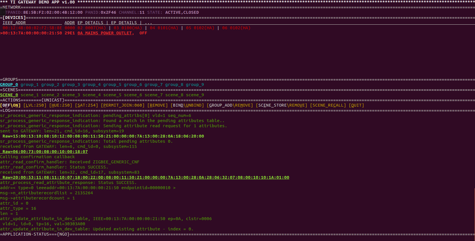

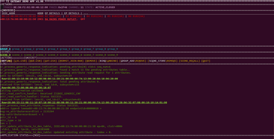

Hi all,
i've successfully start my new ZigBee project using BeagleBoard + cc2531 USB Dongle. I've successfully started sample applicationd and i'm able to add devices into network.
I've just a question. I've  device
- 1 Energy power socket with power consumption reporting and On/Off switch [NetVox Z800]
After join device into network, i'm able to switch On/Off the socket. Device documentation, about power consumption reportin tell:
Paiting for power consumption reporting (Matching)
When the load is attached to the device,the embedded meter reads the supplied power or
voltage and current drawn overtime. Z800 reports the readings to the matched device or
to the coordinator by default if no device pairing is done.
Matching operation:
1. To send out the matching request,switch the manual switch to its down-position
2. Hold press the binding key for 3 seconds. You should see the LED flash once while it
sends matching request to the air. The indicator will flash 6 times upon successful matching
I've follow instructions, but (i see with packet sniffer) power socket sended packets, but no coordinator response. There is a missing step for this?

  • Hi Francesco,
    In the logs that you sent there is no evidence of the device trying to send the power information to the coordinator as a default destination as it should according to your first post.
    Anyway, The gateway can easily be configured to support the match descriptor request that the device send:
    In the log you sent, named 'PairingForPowerConsumptionReporting', you can see in the Match Descriptor Request that there is a single cluster required as an output cluster at the gateway side - ClusterID 0x0702 (Smart Energy / Metering).
    You will need to edit the file gateway_config.tlg, and add the above cluster ID as an output cluster to one of the endpoints that may already be defined there (or add an endpoint of your own).
    Once the tlg is updated, start the gateway (or soft reset it), and then connect the plug to the gateway again (you may need to reset the plug to factory defaults first). The gateway will now automatically respond to the match descriptor request.

    Dear OD,
    thanks a lot for your answer.
    Sorry but i'm newbie on zigbee tecnology. I'm linux specialist.
    I tried to find Cluster ID 0x0702 on my packet sniffer (named PairingForPowerConsumptionReporting), but i'm not able to find it. Please can you could tell me the specific field where i can find it? Is it "APS Cluster Id"? Red coloured?
    I tried to change my gateway_config.tlg as your own, adding "clusterlist CombinedInterfaceOutputClusters { onoff, 0x0702 }" and the other antries as you sample TLG file...but nothing, the behavior is the same.
    Thank you very much for your time

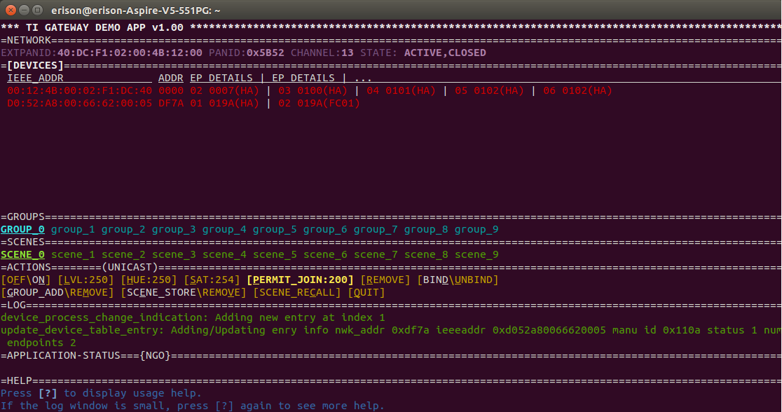

  • Hi OD,
    I bought a SmartSense presence sensor and found it cannot appear in DEVICES list of TI Z-Stack gateway demo app. Do you know how to add endpoint configuration for this kind of sensor? Thanks.
  • If you can provide packet sniffer log, I can have a look on it.
  • I will provide log for you after I got another CC2531 usb dongle. Before that, I have some questions:
    What are the conditions that gateway will list the device? Profile ID, Channel, PAN ID, Device ID and Cluster ID are all essential? Thanks.
  • It is most related to Profile ID, Device ID and Cluster ID.
  • If I can sniffer the packet with channel 13(0x0D), it means the sensor use this channel and I need to set gateway's channel to 13, right? If I don't know the PAN ID of the sensor, can I just set gateway's PAN ID to 0xFFFF?
  • When you use sniffer, you should set channel to your gateway's channel. Device would scan all 16 channels and try to join your gateway. You can set gateway's PANID to any value. If you set it to 0xFFFF, coordinator would generate a random PANID for you.
  • After increasing the seconds of PERMIT_JOIN and trying many times, the sensor appears in devices list. Why does it take long time to appear in devices list? How to make it appear soon? If I remove the battery of sensor, why doesn't it be removed from device list?
  • The speed of joining ZB network is mostly related to device. You cannot do anything to enhance it if you use 3rd party devices. After a device joins GW, GW would keep it on device list until you remove it.
  • After hard reset, the sensor device is removed from device list. I enable PERMIT_JOIN with 255 to make the state always OPEN. I wait long time, the sensor cannot appear in device list. Is this normal? How to check the cause why it doesn't appear in list? Would it be better to set PAN ID to a fixed value?
  • You can use TI packet sniffer to check over the air message.
  • Hi YiKai,
    I got another usb dongle to sniffer the packet. Could you help me check why SmartThings presence sensor cannot appear in device list? Thanks.
    SmartThings_PresenceSensor_06221002.psd
  • I only see a device is doing beacon requests in the sniffer log. There is no coordinator responses to beacon request. Please check if your coordinator is working fine.
  • Hi YiKai,
    How to check the coordinator is working fine? I restart the gateway demo app and power on PIR sensor, then it can appear in devices list. This indicates the coordinator is working fine, right? Then I power down PIR sensor and power on Presence sensor, it still can't appear in devices list. I checked the difference of two sniffer logs. For PIR sensor, there is packet from 0x0000 to 0x5F51. For Presence sensor, there is no packet from 0x0000 to 0xDF7A. This indicates coordinator didn't response to Presence sensor's request? How to debug why coordinator didn't response the request? Thanks.
    PIR_06221124.psd
  • I see ZED (0x5F51) joins your coordinator in sniffer log so there is no problem with your coordinator now. However, I don't see Presence sensor 0xDF7A in your log. Do you do a factory reset to Presence sensor to make it send beacon requests to join your coordinator?
  • After factory reset to Presence sensor, it can appear in device list now. It has endpoint with profile id FC01 and device id 019A. It's customized by SmartThings, not normal id, right? Is "factory reset" a "must" step in ZigBee spec or this is Presence sensor's issue? If I would like to make it disappear in device list when I power down it, I need to modify which part of source code? Thanks.
    SmartThings_PresenceSensor_06221346.psd
  • Yes, it is private profile and format. You can use [REMOVE] on GW to remove the device.
