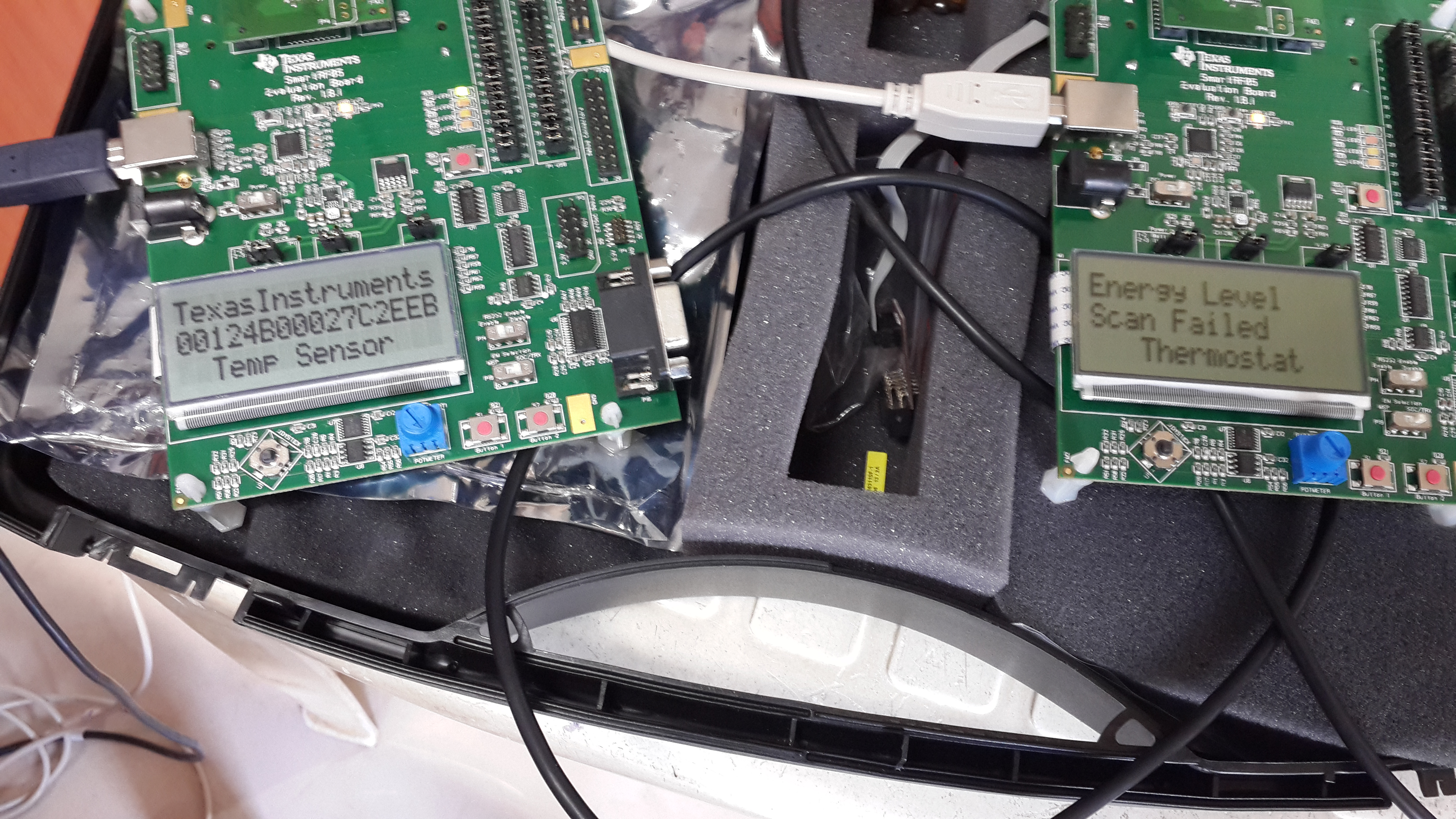

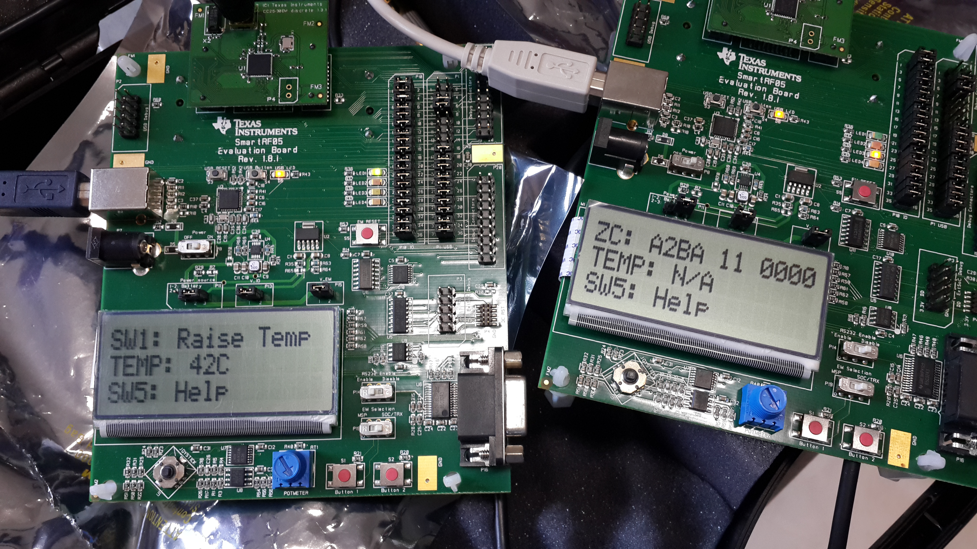

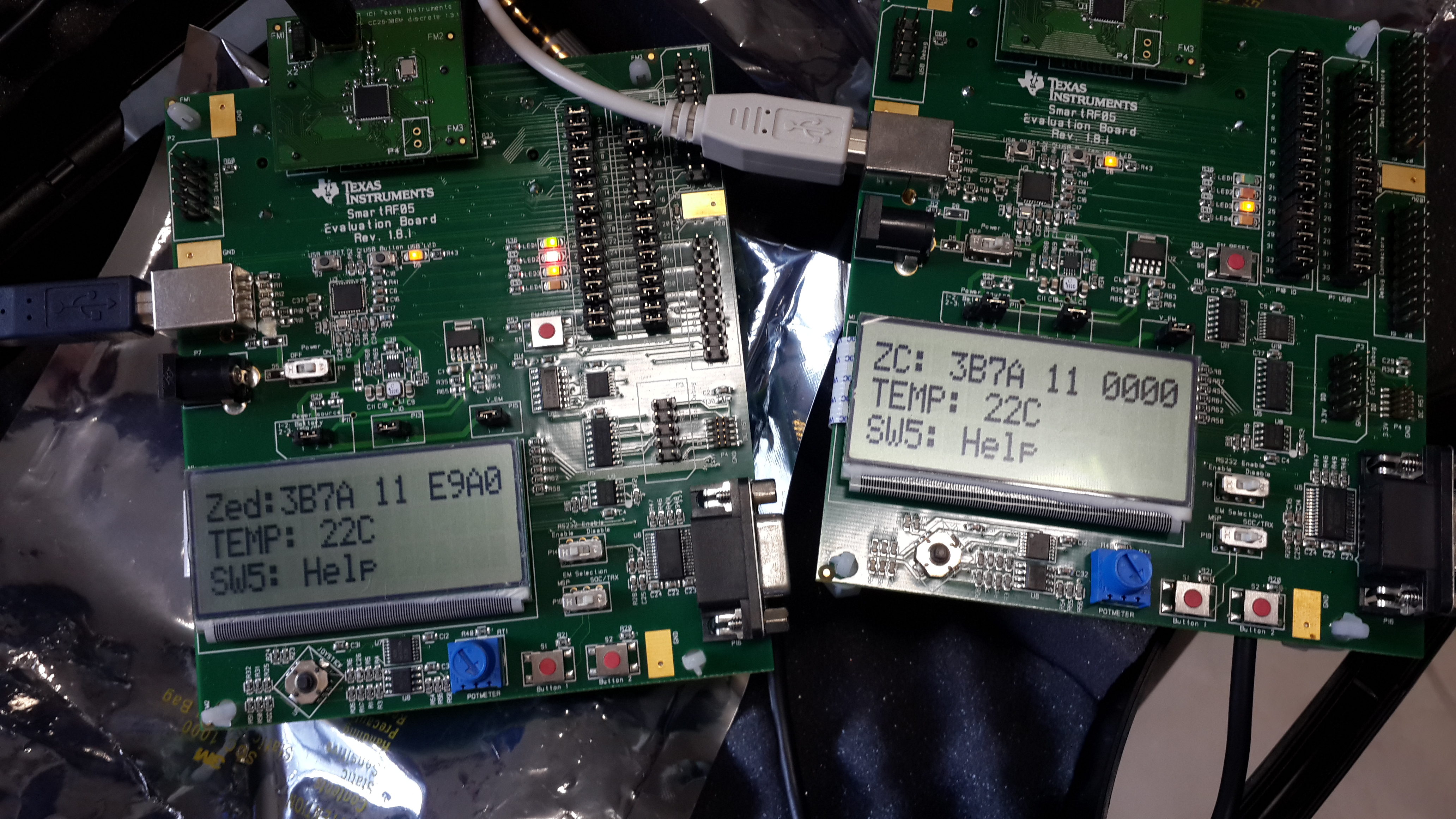

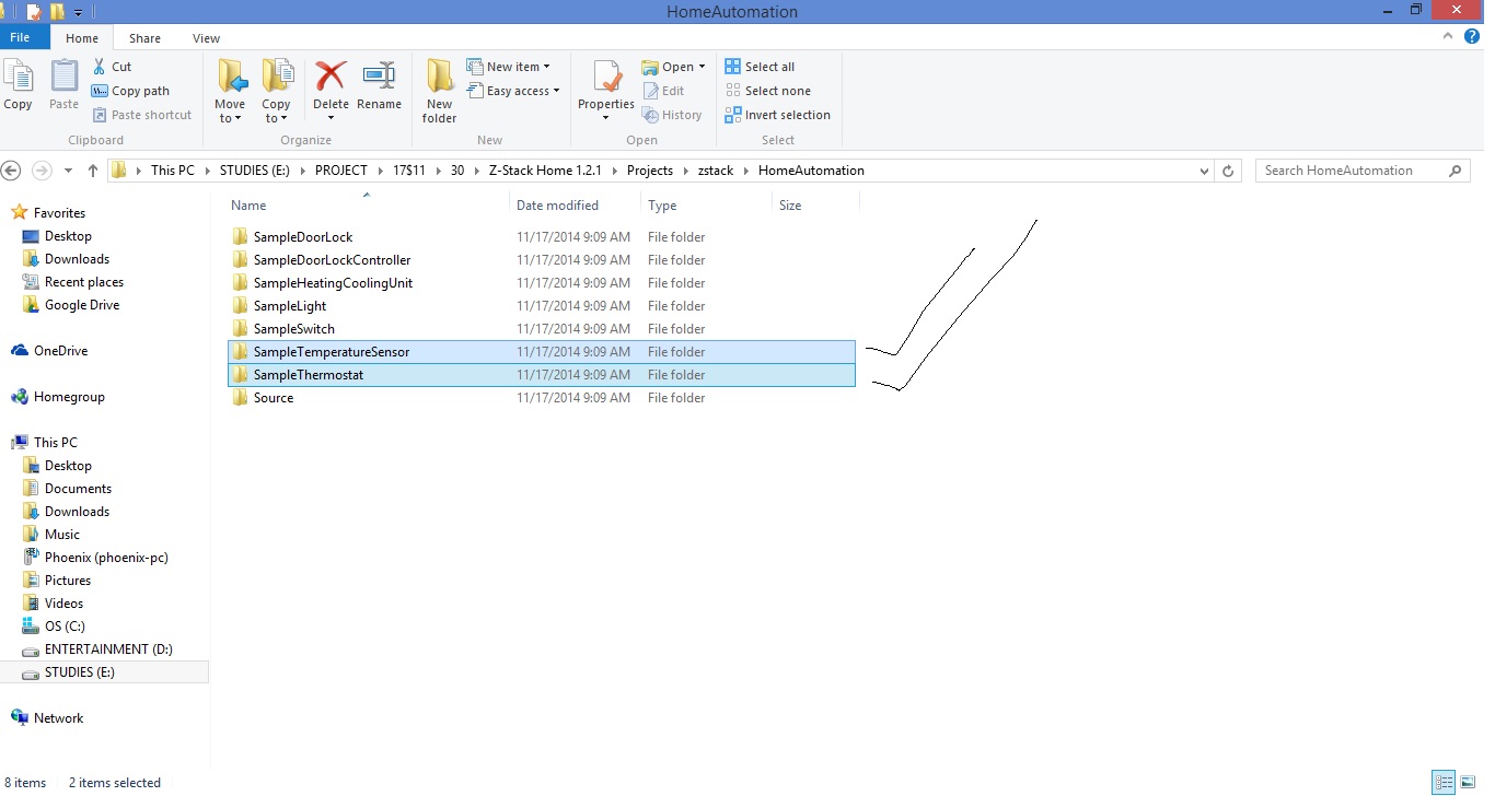

i used the adc to get data from internal temperature sensor and transmit it via zigbee and display it in samplethermostat code dumped board
  • SampleHeatingCoolingUnit is a Zigbee thermostat.
  • sir but i am using the progrm called sample thermotat  in the coordinator node sir !!!
  • It is the same steps to use SampleThermostat as coordinator and SampleTemperatureSensor as end device. Do you follow the steps?
  • so sir ... what u r saying is that my code is correct and the binding steps i have been using was wrong ??

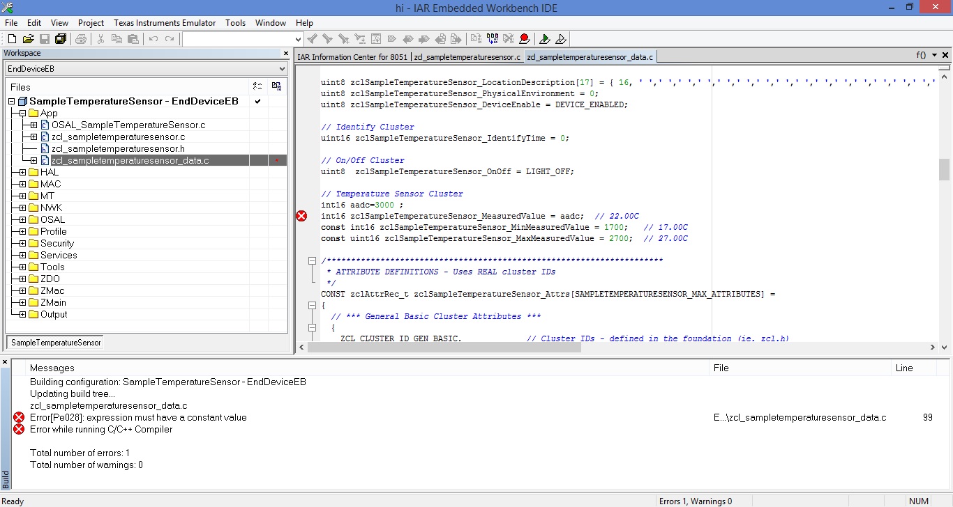

    and is it possible to declare as a variable
    int16 zclSampleTemperatureSensor_MeasuredValue = 2200; // 22.00C in the zcl_temperaturesensor_data.c
    the above zclSampleTemperatureSensor_MeasuredValue is declared as a constant in that .c file ... s there any possibility that i can change it to a variable if i try like this
    int16 aadc==3000;
    zclSampleTemperatureSensor_MeasuredValue = aadc ;
    means it is showing the error of
    Error[Pe028]: expression must have a constant value E:\PROJECT\17$11\new idea\Z-Stack Home 1.2.1\Projects\zstack\HomeAutomation\SampleTemperatureSensor\Source\zcl_sampletemperaturesensor_data.c 99
    Error while running C/C++ Compiler
  • What are you talking about? zclSampleTemperatureSensor_MeasuredValue is not declared as const in the original source code, it is like
    Of course you can declare int16 aadc=3000 (not int16 aadc==3000) and assign it to zclSampleTemperatureSensor_MeasuredValue
  • Wow... You really need to study more hard on programming.... You can't declare a variable like
    int16 zclSampleTemperatureSensor_MeasuredValue = aadc;
    You can only assign a variable to another variable in code. for example:
      if (events & SAMPLETEMPERATURESENSOR_ADC)
        zclSampleTemperatureSensor_LcdDisplayUpdate();
        osal_start_timerEx( zclSampleTemperatureSensor_TaskID, SAMPLETEMPERATURESENSOR_ADC, SAMPLETEMPERATURESENSOR_REPORT_INTERVAL );
        return ( events ^ SAMPLETEMPERATURESENSOR_ADC );

    in this pgm the ZED is displaying a value 42 in its led but it s not transmitting to coordinator node sir ?? any comment on why pl
  • I have asked you several times.
    Do you do the following steps on your coordinator and end device?
    1. Power  on  the  SampleThermostat,  SampleTemperatureSensor,  and SampleHeatingCoolingUnit  boards.  Once  powered  up,  LCD  will  show  “Texas Instruments”, the MAC address, and the device name. When the coordinator has formed a network, the screen will appear as  shown  in  Figure  19  and the devices will be ready for
    EZ-Mode pairing.
    2. To  pair  the  devices  using  EZ-Mode,  press  SW2  on  the  SampleThermostat  and SampleHeatingCoolingUnit;  after  which,  EZMODE  will  display  on  the  2nd line  of  the LCD  screen.  Repeat  the  pairing  process  for  the  SampleThermostat  and SampleTemperatureSensor.  If  pairing  is  successful,  2nd line  will  display:  “EZMODE: SUCCESS”. If the device is the EZ-Mode “initiator”, the “target” device’s information will be displayed on the initiator’s 2
    nd line. LED1 will blink throughout this process until EZ-Mode  pairing  has  finished.  Refer  to  Figure  20.  EZMODE  device’s  information  or status will disappear after few seconds.
    3. Once all three devices have been successfully paired, current temperature reading will be sent from the SampleTemperatureSensor to the SampleThermostat every 10 seconds.
  • sir i am using only two nodes sir
  • You don't run coordinator correctly on Thermostat. Please check it.
  • i cleared it sir .. i ran the sample codes in the nodes and they are working properly i mean the value in the ZED is displayed in the coordinator ... (ie if a value is 22 in lcd of ZED it s also shown in coordinator)
    but if i altered the code in ZED just a value 42 is diaplayed it is not varrying with respect to the temperature and it s not displayed in coordinator
  • after i dumb the modified code the ezmode: which show while pressing sw2 is not at all showing sir
  • Can you show me your latest zcl_sampletemperaturesensor.c, zcl_sampletemperaturesensor.h and zcl_sampletemperaturesensor_data.c

    // Temperature Sensor Cluster
    //int16 aadc = 30;
    //int16 zclSampleTemperatureSensor_MeasuredValue = aadc;  // 22.00C
    const int16 zclSampleTemperatureSensor_MinMeasuredValue = 1700;   // 17.00C
    const uint16 zclSampleTemperatureSensor_MaxMeasuredValue = 2700;  // 27.00C

  • where s the code going wrong sir ???
  • It seems that your coordinator is not started correctly. Otherwise you should see ZC on LCD of Sample thermostat.
  • no sir there is no pblm in my thermostat it is working properly when i dumb the sample code without changing it and when i change the sampletemperaturesensor code and then dumb it in my ZED it s showing like that sir
  • If your coordinator (SampleThermostat) is start correctly, you should see something like the attached image. But I don't see it from your previous answer.
  •  it is showing like this when i dump the example pgm for thermostat and temperaturesensor but when i change the code of sample temperature sensor it is not working sir
  • one more problem is when i use the internal temp sensor of ZED in the lcd of the ZED it is showing a value 42c nothing more or nothing less ... it s not even flutuating when i keep my hand in the chip for heating it up !!
  • How is it possible that you change SampleTemperature sensor code but Sample Thermostat doesn't work? In the screen shot, the right SmartRF05EB+CC2530EM is ZC runs Sample Thermostat, right? You don't have to change anything on it. You only program your revised Sample Temperature ZED to the left SmartRF05EB+CC2530EM.
  • yes sir i didnt change anything in thermostat .... i only chanaged the temperature sensor program
    and the temp value is cming as 42c it is not at all varying sir !!!!

    int16 zclSampleTemperatureSensor_MeasuredValue;

  • Do you press  SW2  on both Sample Temperature and Thermostat after you flash your revised FW into Sample Temperature?
  • yes sir !!! but the pblm is the sw2 is not at all working in the sample temperaturesensor when i dump the modifies code sir
  • sir i modified the code and made even both the nodes to communicate sir .... the adc value is flutuating between 14 to 17C only . it is not even steady ... i just minimized the adc code which i wrote earlier ...
    int16 AvgTemp;
    uint8 i;
    uint16 AdcValue;
    uint16 value;
    uint16 value1;
    //char i;
    //char TempValue[10];
    //initTempSensor();
    AdcValue = 0;
    for( i = 0; i < 4; i++ )
    ADCIF = 0;
    ADCCON3 = (HAL_ADC_REF_125V | HAL_ADC_RESOLUTION_14 | HAL_ADC_CHN_TEMP); // ??1.25V????,12????,AD??:?????
    while ( !ADCIF ); //?????ADC
    value = ADCL >> 2;
    value |= (((UINT16)ADCH) << 6);
    AdcValue += value;
    value = AdcValue >> 2; //????4,?????
    //value1 = (((value) >> 4) - 335);
    //??AD?,????????
    // while(1)
    //AvgTemp = 0;
    //for(i = 0 ; i < 64 ; i++)
    //AvgTemp += value1;
    //AvgTemp >>= 1; //??????2.
    zclSampleTemperatureSensor_MeasuredValue = value ;
    zclSampleTemperatureSensor_SendTemp();
  • any idea on why that adc value is fluctuating sir ???
  • I have told you that you can not have a while(1) in your code and that is why your SW2 doesn't work. You can see that your Sample Temperature and Sample Thermostat can communicate after you comment out the while(1).
  • sir i commmented that while loop whn u then itself ... now every communication and all are working fine sir !!! the problem is the sensor value it is giving a random value from 55 to 75 ...... and it is not continuous it s jst random value .. not even increasing or decreasing in a proper way !!!!

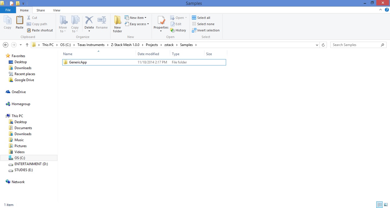

  • There is an example SensorDemo in Z-Stack Mesh 1.0.0 that show you how to read temperature using ADC.
  • sir i already did the adc coding using the simpleapp example in ZStack-CC2530-2.3.0-1.4.0 .....
     s the pgm in Z-Stack Mesh 1.0.0 is differ from the simpleapp example sir ???
  • Sample codes of Z-Stack Mesh 1.0.0 and  ZStack-CC2530-2.3.0-1.4.0 are similar but your code for temperature reading is not the same with myApp_ReadTemperature() in Z-Stack-CC2530-2.3.0-1.4.0.
  • and in Z-Stack Mesh 1.0.0 sensor demo program is not there sir
  • yes sir .. its kinda different u r suggesting that i can use myApp_ReadTemperature() pgm to read the temperature sensor ??
  • If you install Z-Stack Mesh 1.0.0, you should find it in C:\Texas Instruments\Z-Stack Mesh 1.0.0\Projects\zstack\Samples\SensorDemo\Source\DemoSensor.c
  •  i dont have that file sir ... i will try with myapp_gettemperature() pgm in simpleapp
  • if (events & SAMPLETEMPERATURESENSOR_ADC)
    uint16 value;
    int16 value1;
    /* Clear ADC interrupt flag */
    ADCIF = 0;
    ADCCON3 = (HAL_ADC_REF_125V | HAL_ADC_DEC_512 | HAL_ADC_CHN_TEMP);
    /* Wait for the conversion to finish */
    while ( !ADCIF );
    /* Get the result */
    value = ADCL;
    value |= ((uint16) ADCH) << 8;
    #define VOLTAGE_AT_TEMP_ZERO 5158
    #define TEMP_COEFFICIENT 14
    // limit min temp to 0 C
    if ( value < VOLTAGE_AT_TEMP_ZERO )
    value = VOLTAGE_AT_TEMP_ZERO;
    value = value - VOLTAGE_AT_TEMP_ZERO;
    // limit max temp to 99 C
    if ( value > TEMP_COEFFICIENT * 99 )
    value = TEMP_COEFFICIENT * 99;
    //return ( (uint8)(value/TEMP_COEFFICIENT) );
    value1 = value/TEMP_COEFFICIENT ;
    zclSampleTemperatureSensor_MeasuredValue = value1 ;

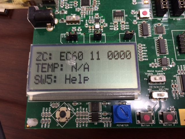

    i got the pgm from simpleapp and while running the same the lcd is displaying only 0 and it can be changed by button SW1 .... any idea y sir ???
  • Change zclSampleTemperatureSensor_MeasuredValue = value1 ; to zclSampleTemperatureSensor_MeasuredValue = value1*100 ;
  • it is showing 99c in the lcd and the value changes while pressing the buttons ... it is not atall updating the values itself ..
    in normal simpleapp example a minute variation in temperature of chip it will update the value but in this pgm the value is at 99c as we speak sir
  • Try the following function.
    int16 readTemp(void)
      static uint16 voltageAtTemp22;
      static uint8 bCalibrate=TRUE; // Calibrate the first time the temp sensor is read
