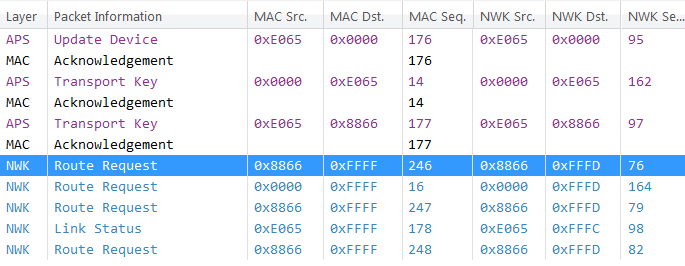

We meet a weird situation that a router does not forward route requests. The topology is shown as below.
ZC --- ZR1 (0xE065) --- ZR2 (0x8866)
Both of ZC and ZR2 issue a route request (radius=5) but ZR1 doesn’t forward those requests.
I don't know why?
Please help to check this issue.
Thank you.
Boer Wei

  • Hi CYLin,
    It is observed that the network frame counter of all the packets from 0x8866 is 0xFFFFFFFF(4294967295) which is the maximum value. The ZC and 0xE065 cannot accept any packet from 0x8866 because the network frame counter has never incremented since it sent Device Announce(which seems missed by the sniffer).
    Do you have any different configurations on 0x8866 from those on 0xE065? I have never seen the case where network frame counter naturally reaches the maximum value. Can you factory reset 0xE065 and retry?
    - Cetri

  • We have already enabled the NV_RESTORE and the symptom still the same. The attached file is captured by Wireshark and the topology is shown below. You can see the route request packet (src=0x15aa) from No.236 to No.280 that does not re-broadcast by ZR1. Do there still have anything wrong?

  • Hi CYLin,
    The last issue is a totally irrelevant with the original one of this thread. However, it is a known issue.
    In current implementation of Z-Stack, if the concentrator have done MTO route discovery and the routers have gotten the routes targeting the concentrator as a result, the routers will ignore route requests from another router looking for the concentrator because they suppose every router in the network has the MTO route entry associated with the concentrator.
    In your case, the ZC initiated a MTO route discovery at #233. That was repeated by 0x7737 at #234. Than means 0x7737 got to have the MTO route entry targeting the concentrator(ZC). I guess 0x15AA was powered off so didn't receive the MTO route request. After a while, 0x15AA came back and sent out a route request looking for the ZC at #236. 0x7737 was able to hear that message but ignored because the destination of the route request was the concentrator. This problem lasted until the concentrator issued another MTO route discovery(#281) and 0x15AA received it(#283).
    Although this problem is seen only temporarily until every router receives MTO route request, I agree it brings inconvenience. So we have removed this constraint and therefore the new version of Z-Stack(coming up in a few weeks) will be behaving as you desire.
    - Cetri
