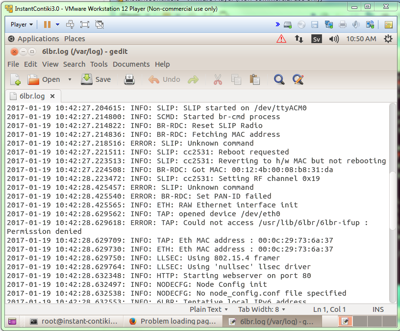

  • Can you attach 6lbr.log under /var/log?
  • It cannot connect to your slip radio. What HW do you use as slip-radio and how do you build slip radio FW?
  • I'm using cc2531 usb dongle as slip radio with FW cc2531-slip-radio_contikimac.zip
    which u have sent me previously.
    How to proceed?
    do I need to change the FW?
  • Try to download FW cc2531-slip-radio_contikimac to your CC2531EMK and test again.

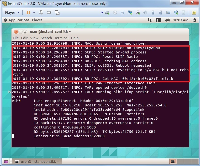

  • Yes, that's why I suspect there is something wrong on your CC2531 USB dongle. Do you see similar lines to the followings in your 6lbr.log
    2017-01-20 5:58:27.561900: INFO: SLIP: SLIP started on /dev/ttyACM0
    2017-01-20 5:58:27.576904: INFO: SCMD: Started br-cmd process
    2017-01-20 5:58:27.576924: INFO: BR-RDC: Reset SLIP Radio
    2017-01-20 5:58:27.576928: INFO: BR-RDC: Fetching MAC address
    2017-01-20 5:58:27.581012: INFO: SLIP: cc2531: Reboot requested
    2017-01-20 5:58:27.582401: INFO: SLIP: cc2531: Reverting to h/w MAC but not rebooting
    2017-01-20 5:58:27.583881: INFO: BR-RDC: Got MAC: 00:12:4b:00:02:f1:d7:1b
  • 2017-01-20 6:07:11.818033: INFO: SLIP: SLIP started on /dev/ttyACM0
    2017-01-20 6:07:11.830765: INFO: SCMD: Started br-cmd process
    2017-01-20 6:07:11.830788: INFO: BR-RDC: Reset SLIP Radio
    2017-01-20 6:07:11.830800: INFO: BR-RDC: Fetching MAC address
    2017-01-20 6:07:11.865109: INFO: SLIP: cc2531: Reboot requested
    2017-01-20 6:07:11.867082: INFO: SLIP: cc2531: Reverting to h/w MAC but not rebooting
    2017-01-20 6:07:11.868065: INFO: BR-RDC: Got MAC: 00:12:4b:00:08:b8:31:da

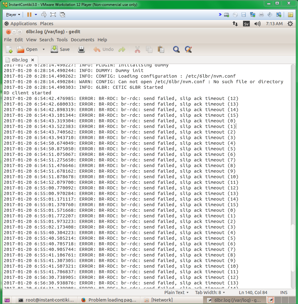

  • Can you attach your latest 6lbr.log?
  • thats the latest. system time is 7: 11 am now of vm ware. so you can relate.
  • I'm getting this error after RD client is started.

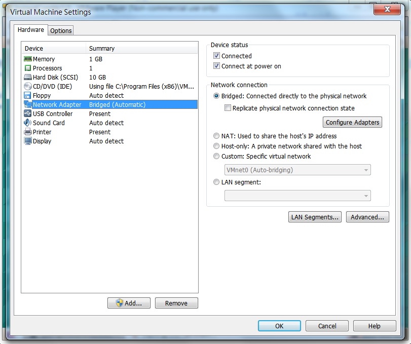

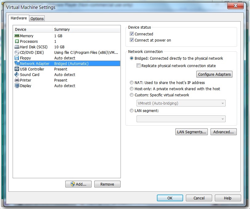

  • Do you use "Bridged" in Network Adapter settings of VM Player?
  • I made that to bridge. it was in NAT. but after then still its not working.
  • Do you restart everything after you change it to bridge? Please attach your latest 6lbr.log.

    2017-01-20 10:06:37.463157: NOTICE: 6LBR: Starting 6LBR version 1.5.x (Contiki-develop-20161222)
    2017-01-20 10:06:37.463330: INFO: ETH: 6LBR watchdog started (interval: 60)
    2017-01-20 10:06:37.472600: INFO: PLUGIN: Loading /usr/lib/6lbr/plugins/lwm2m.so
    2017-01-20 10:06:37.472709: INFO: PLUGIN: Initialising lwm2m-client
    2017-01-20 10:06:37.472718: INFO: PLUGIN: Loading /usr/lib/6lbr/plugins/dummy.so
    2017-01-20 10:06:37.472794: INFO: NVM: NVM Magic : 2009
    2017-01-20 10:06:37.472799: INFO: NVM: NVM Version : 5
    2017-01-20 10:06:37.472805: INFO: CONFIG: Loading configuration : /etc/6lbr/nvm.conf
    2017-01-20 10:06:37.472813: WARN: CONFIG: Can not open /etc/6lbr/nvm.conf : No such file or directory
    2017-01-20 10:06:37.472824: NOTICE: 6LBR: Log level: 30 (services: ffffffff)
    2017-01-20 10:06:37.472828: INFO: MAC: Using 'csma' mac driver
    2017-01-20 10:06:37.472853: INFO: SLIP: SLIP started on /dev/ttyACM0
    2017-01-20 10:06:37.496345: INFO: SCMD: Started br-cmd process
    2017-01-20 10:06:37.496427: INFO: BR-RDC: Reset SLIP Radio
    2017-01-20 10:06:37.496443: INFO: BR-RDC: Fetching MAC address
    2017-01-20 10:06:38.514134: INFO: BR-RDC: Fetching MAC address
    2017-01-20 10:06:38.528992: INFO: BR-RDC: Got MAC: 00:12:4b:00:08:b8:31:da
    2017-01-20 10:06:39.721599: INFO: SLIP: cc2531: Setting RF channel 0x19
    2017-01-20 10:06:39.760874: ERROR: SLIP: Unknown command
    2017-01-20 10:06:39.760914: ERROR: BR-RDC: Set PAN-ID failed

    2017-01-20 10:06:40.584904: ERROR: BR-RDC: br-rdc: send failed, slip ack timeout (1)
    2017-01-20 10:06:40.604800: ERROR: SLIP: Unknown command
    2017-01-20 10:06:40.604839: INFO: BR-RDC: Reset SLIP Radio
    2017-01-20 10:06:40.619798: INFO: SLIP: cc2531: Reboot requested
    2017-01-20 10:06:40.620809: INFO: SLIP: cc2531: Reverting to h/w MAC but not rebooting
    2017-01-20 10:06:40.622745: INFO: SLIP: cc2531: Setting RF channel 0x19
    2017-01-20 10:06:40.785220: ERROR: BR-RDC: br-rdc: send failed, slip ack timeout (2)
    2017-01-20 10:06:40.924811: ERROR: SLIP: Unknown command
    2017-01-20 10:06:40.924848: ERROR: BR-RDC: Set PAN-ID failed
    2017-01-20 10:06:41.260197: ERROR: BR-RDC: br-rdc: send failed, slip ack timeout (5)
    2017-01-20 10:06:41.461431: ERROR: BR-RDC: br-rdc: send failed, slip ack timeout (6)
    2017-01-20 10:06:41.661525: ERROR: BR-RDC: br-rdc: send failed, slip ack timeout (7)
    2017-01-20 10:06:41.861443: ERROR: BR-RDC: br-rdc: send failed, slip ack timeout (8)
    2017-01-20 10:06:42.062690: ERROR: BR-RDC: br-rdc: send failed, slip ack timeout (9)
    2017-01-20 10:06:42.263959: ERROR: BR-RDC: br-rdc: send failed, slip ack timeout (10)
    2017-01-20 10:06:42.465183: ERROR: BR-RDC: br-rdc: send failed, slip ack timeout (11)
    2017-01-20 10:06:42.666432: ERROR: BR-RDC: br-rdc: send failed, slip ack timeout (12)

    2017-01-20 10:06:53.751266: ERROR: BR-RDC: br-rdc: send failed, slip ack timeout (13)
    2017-01-20 10:06:53.894481: ERROR: SLIP: Unknown command
    2017-01-20 10:06:53.894616: ERROR: BR-RDC: Set PAN-ID failed
    2017-01-20 10:07:36.772584: ERROR: BR-RDC: br-rdc: send failed, slip ack timeout (1)
    2017-01-20 10:07:36.974900: ERROR: BR-RDC: br-rdc: send failed, slip ack timeout (2)
    2017-01-20 10:07:37.071448: ERROR: BR-RDC: br-rdc: ack received for unknown packet (1)
    2017-01-20 10:07:37.177380: ERROR: BR-RDC: br-rdc: send failed, slip ack timeout (3)
    2017-01-20 10:07:37.211487: ERROR: BR-RDC: br-rdc: ack received for unknown packet (2)
    2017-01-20 10:07:37.351474: ERROR: BR-RDC: br-rdc: ack received for unknown packet (3)
    2017-01-20 10:07:37.379879: ERROR: BR-RDC: br-rdc: send failed, slip ack timeout (4)
    2017-01-20 10:07:37.490440: ERROR: BR-RDC: br-rdc: ack received for unknown packet (4)
    2017-01-20 10:07:37.582375: ERROR: BR-RDC: br-rdc: send failed, slip ack timeout (5)
    2017-01-20 10:07:37.629463: ERROR: BR-RDC: br-rdc: ack received for unknown packet (5)
  • I still suspect there is something wrong with your CC2531EMK. Do you have another CC2531EMK for testing?
  • Nope.I dont have extra.
    Even I feel the same. dongle is not ack back.
