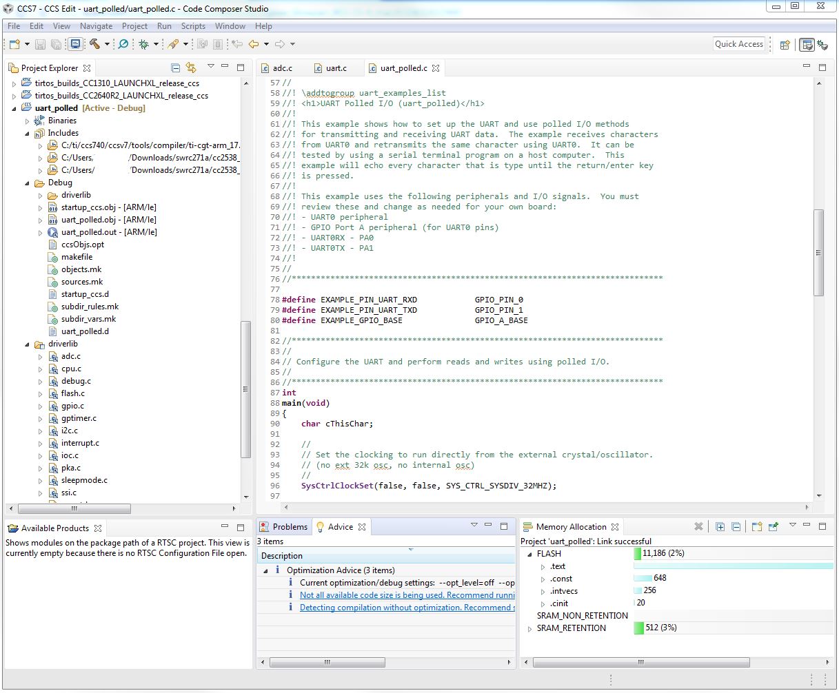

I am migrating functions from IAR to CCS. I'm having difficulty finding references in C to implement the intrinsic functions (intrinsics.h) used in the cc2538 project to compile using the code composer. Would anyone have any suggestions?
  • Vanessa Borba,
    I just downloaded the software foundation and it does actually contain 4 older CCS compatible projects. I managed to import these projects into CCS7.4 and after messing with the include paths and creating a new generic Cortex-M3 processor the project compiled without errors.
    I do not think you need the intrinsics.h file for CCS.
