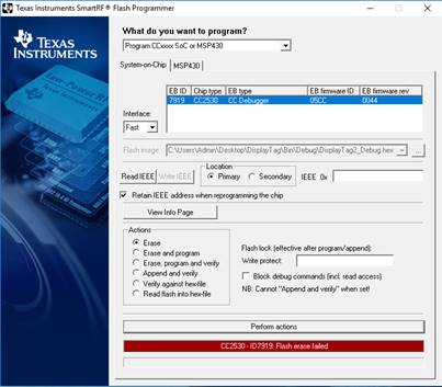

Background
After programming the following main application, the CC debugger can identify the device type but the SmartRF Flash Programmer fails to erase the flash with a "CC2530 - ID 7919: Flash erase failed".
void main(void)
  SLEEPCMD = ( 0x02 | 0x04);       //PM Level | Reserved
  PCON = 1;                        //Enter Sleep Mode
  asm("nop");
My assumption is that the device is too quickly entering PM2 and SmartRF Flash Programmer can no longer communicate with the device.
Question
Is there an alternative method to recover a device programmed this way?
Are there any other reasons for the SmartRF Flash Progammer to fail flash erase?
