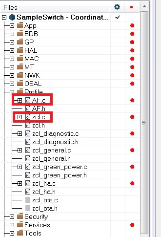

    3.I can't find AF.c and zcl.c. can you please tell me where can I find them?
    5.What do you mean from test it? how do I test it?
    6.can you introduce me a site that have some example to explain sample app of zstack step by step?
  • 1&2. No. You should define your own event ID like SAMPLEAPP_END_DEVICE_REJOIN_EVT in zcl_samplesw.h and call osal_start_timerEx to start the event. Then, add event processing in zclSampleSw_event_loop.
    3.
    5&6. The only guide/document is Z-Stack 3.0 Sample Application User's Guide.pdf under Z-Stack Documents folder.

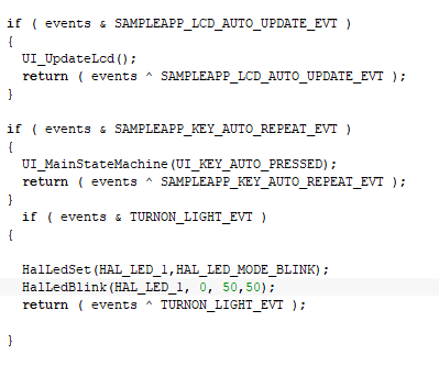

  • I define my event ID like this.
    and call osal_start_timerEx  here
    and then write my event processing here
    but it never run zclSampleSw_event_loop and my code doesn't work.
    what is my wrong here?

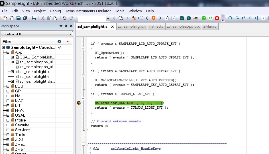

  • Do you run IAR Debugger to check if ret is equal to 0 ?
  • yes. I use this code to check ret value. I set a break point and then debug the code. I see if statement doesn't run and this mean ret value is equal to  0.
  • Can you show me where you put TURNON_LIGHT_EVT in zclSampleLight_event_loop?
  • I define the event in zcl_samplelight.h:
    and then define event processor in zclSampleLight_event_loop(...) in zcl_samplelight.c:
    I try to debug this code without if statement but it doesn't run. and when I call the zclSampleLight_event_loop(..) like something I explain in last comments the if statement is running. I mean the condition of if is true.

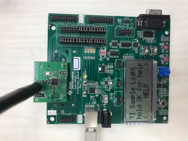

  • I do the same test on my CC2530DK and I can see it hits breakpoint inside TURNON_LIGHT_EVT event.
    I attached my zcl_samplelight.h/zcl_samplelight.c for your reference.
