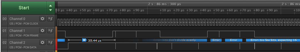

The following screenshot shows the output on console uart when connected to smartphone bluetooth. Also Log file is here
Also the Logic analyzer screenshot for I2S Lines
Full modified project source is here for download.
The CODEC I2C part works fine, only I2S part seems to be a problem.

  • Fixed an STM32 PLL config setting, now the "Dropping x SBC Frames" doesn't appear.
    As the TI demo sample was prepared for STM3240G-EVAL board, it has the Crystal 25MHz. But the Discovery board has Crystal 8MHz.
    The PLL_M value in system_stm32f4xx.c has to be changed from 25 to 8.
    #define PLL_M      8 //25
    But still no luck, can't hear the Audio on Discovery board. It seems I2S PLL clock setting is the problem ( as the code written for STM3240G-EVAL board derives PLL clock from 25MHz Crystal).
    I guess, the following lines of code in AUDIO.C should be modified.
    static BTPSCONST FrequencyConfiguration_t FrequencyConfiguration[] =
      {44100, (2 << 28) | (429 << 6), (1 << 8) | 9},
      {48000, (2 << 28) | (344 << 6), (0 << 8) | 7},
    Also, the following in AUDIO.C
    RCC->PLLI2SCFGR  = FrequencyConfiguration[0].PLL_I2S;
    Any kind of help would be great
