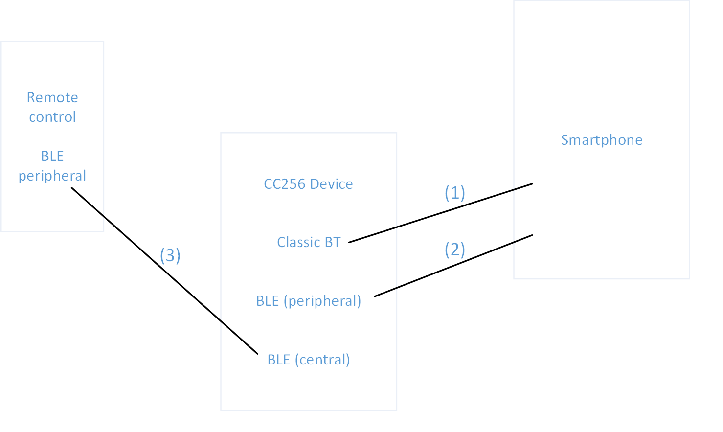

  • What we need is:
    - Classic A2DP, for listening to media (unassisted, need to decode audio on host processor)
    - Classic HFP, for making phone calls (I believe HFP supersedes HSP, so HSP is not necessary? unassisted, need to encode/decode audio on host)
    - Classic AVRCP, for controlling the audio streams
    - BLE connected to phone (CC256 as peripheral, phone as central), would be used to send commands/check status (battery, etc.)
    - BLE connected to remote control (CC256 as central, remote control as peripheral) simple remote with a couple buttons.
    We want to be connected and paired to the remote control always. The other classic and BLE connection would be to the same device/phone. Simultaneous connection, as in the diagram below:
    Example use case:
    If we are in a HFP phone conversation through our device (1), we want to use the remote control to change volume through BLE connection (3) to our device, and then up to the phone through AVRCP (2). Couple minutes later I may want to check the battery status or the FW version on the device, through the BLE connection to the phone(2). Or I may want to change eq settings on our device by using the BLE connection with the phone (2). (still while in the call)
    All connections shall be secure and encrypted.
    All devices shall be able to pair and bond.
    As we would like to port it to a low power processor, what would the processor requirements be? Flash/Ram?
    I hope this is enough detail, please ask any questions, thank you.
    Going over your scenarios it can be supported by the CC2564C.
    It can act as a BLE central and peripheral at the same time while having a classic connection to the phone at the same time.
    Please note that this is a complicated scenario - because you are having a voice call which is a synchronous connection
    while at the same time acting as both BLE central and peripheral.
    So supporting such a connection will require thinking about the specific intervals of the BLE connections in order to optimize the system performance.
    BR,
    Chen Loewy
