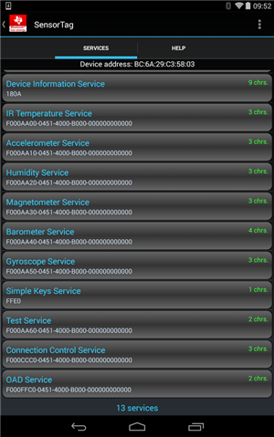

I work on CC2541, i would like to add the service "firmware update" to use with the Android application "BLE Device monitor" (V 1.12).
I use the program BLE Device monitor (V 1.2) on my computer and it works, but not with Android application.
In my software (for the CC2541), I added "Connection Control Service" as it is in the SensorTag software (V 1.4).
CcService_AddService( GATT_ALL_SERVICES ); ... VOID CcService_RegisterAppCBs( &sensorTag_ccCBs ); VOID GAPRole_RegisterAppCBs( ¶mUpdateCB );
That's all and the Android application "BLE Device Monitor" can see this service.
I don't know why it doesn't work, maybe I have forgot to set something...
