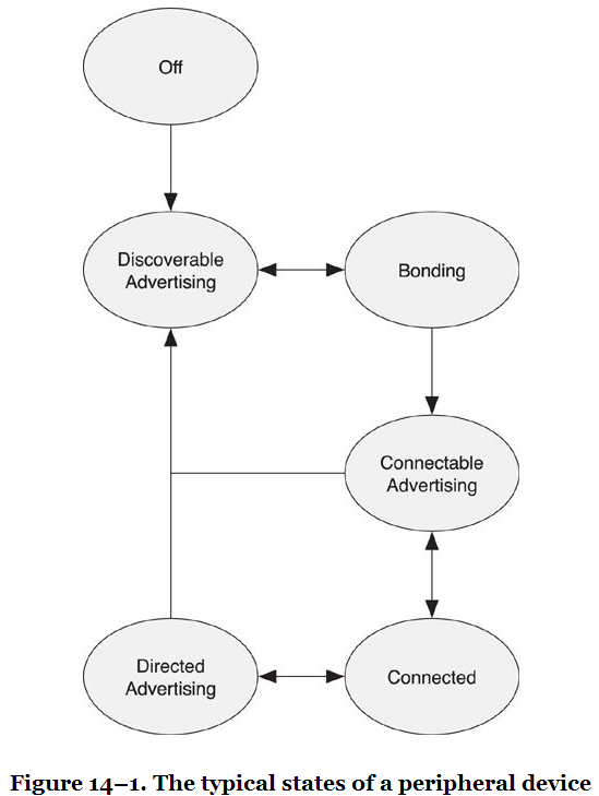

I've found the following figure in a developer's BLE handbook, which shows a number of states a peripheral device can be in:
However in TI's stack (peripheral.h), states are different:

Most important states which are missing is directed advertising and connectable advertising.
Am i just looking in the wrong place?
  • Hello Andrey,
    The figure is named typical states and should therefore not be considered a complete overview. For example the peripheral device can be set up to send non-connectable advertisements as well. Within the state advertising you can set the type of advertising you want. So all the different forms of advertisements are within this same state, but with different configurations. In SimpleBLEPeripheral this is initially set in the GAPRole_Init function where the following is set:
    gapRole_AdvEventType = GAP_ADTYPE_ADV_IND;
    Which is Connectable undirected advertisements. You can change this, but if you change it here you will need to modify the advertisement data and more to be consistent.
