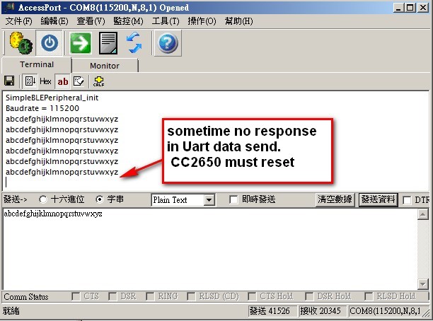

CC2650 Uart receive Data and UART write (Echo test ) , sometime Chip have holding on.
BLE can not connect and Find it on Holding time.
Do you have any suggestion?

    It's hard to understand what is going on. Can you share your project setup details (i.e. SimpleBLEPeripheral)
    Also, your screen shot is using 115200 baud, but you are configuring for 9600 in code.
    Can you explain the BLE issues in more detail?

  • I use SimpleBLEPeripheral project modify
    baud is 115200 8 1 n And  Read use call back mode

  • Had the same problem,
    I notice that only UART with call back is working (as seen in the NPI example).
    And if you using UART_write too frequently, the data is corrupted.
    So i build up an UART task with message queue and memory allocation. the call back used to semaphore the task.
    It was the only way i succeed to handle it.
  • Yes , Uart write too freq , the data is corrupted.
    Read data again then system is crash.
    Write data use call back then read after call back .
    this issue is fix.
