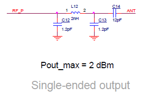

The CC26xx HW Training shows this option for single ended output with internal bias:
1.) Is this a filter or impedance matching?

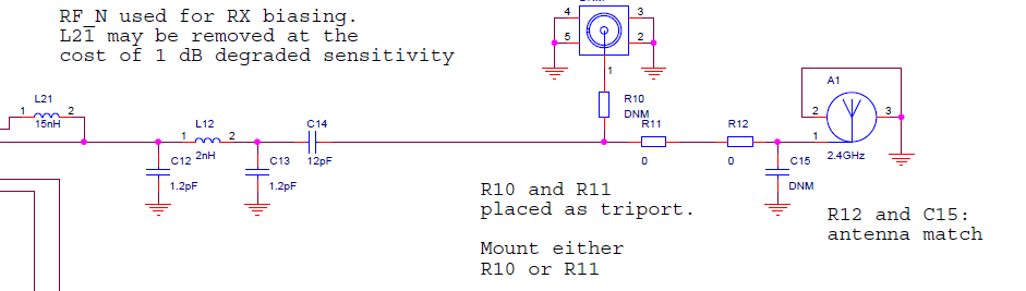

Looking at a reference design for single ended output, I see that there are additional antenna matching components (R12 & C15):

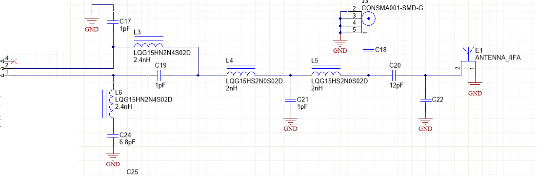

This design does not use the antenna in AN043 but looking at the CC2511 USB dongle which is the reference design for the AN043 antenna, the schematic is even more complicated and does not seem to correspond to the first schematic above at all:
2.) What is the most simple way to get this antenna working with the CC2640? My project is mostly about programming, I don't have time to spend on antenna design.
    Refer to  SimpleLink CC2650 EVM Kit 4XD (CC2650EM-4XD) v1.0.3 Design Files
    Altho it's not the same antenna, the feed point is matched to 50Ohm antenna, means
    that the antenna in current design can be replaced with the one from DN0043.
  • Thanks for the response. The second screenshot from my original post is from that reference design. Can you explain the use of the 0 Ohm resistor R12 and the DNM (do not mount) capacitor C15?
  • These parts are used as placeholders for matching filter.
    Once a PCB produced and the RF parameters are measured, sometimes there's a need (practically always)
    to tune matching between RF path and the antenna.
    If you aren't going to do this kind of tuning, you can leave these placeholders as is, or remove R10, R11, R12, C15,
    making the left pad of R10 your new feeding point. By the way, the track from RF path to SMA connector may
    be omitted too.
  • Thanks, that helps a lot. The problem is, I am not sure if tuning will be necessary. If there is a chance the antenna won't work without this tuning I would like to be sure I have the option to add the matching components. Would a solder bridge work in place of the 0 ohm resistor?
  • It is easier, safer and cheaper to place a footprint for 0R resistor rather than solder bridge.
    If everything done correctly, this design of yours dhould be working OK, not in an optimal way, but OK.
    For people who don't understand a thing in RF matching (like me) reference designs are a MUST,
    and of course a bit of luck.
