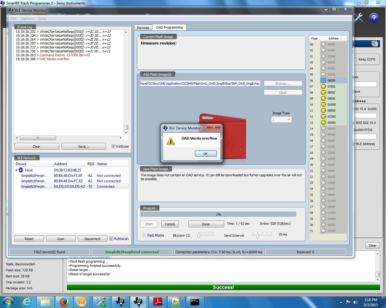

 I have followed all the steps as per the OAD document. But when I press the start button, it shows OAD block overflows warning and everything stops. The device gets disconnected. And it needs to flash again to work.
I am trying to use the Onchip flash and flashing ImageB. My target app resides on CC2650 TI EM 5x5 and downloader is CC2540 USB dongle with BLE device Monitor running .
Chip Rev. 2.2 SDK :2.1

    Then I click on Program (OAD) option in the FILE menu.
    Then I select the hex file (Image B) and press the start button for download.
    It starts and soon the message pops up that OAD blocks overflows
    Can you change the Connection parameters to 10ms with slave latency of zero before starting OAD? You can change it in BLE device monitor options->Gap Settings.

  • Hi Abhiijeet,
    From the screenshot in your original post of this thread, 'Fast mode' is checked. Can you try with it unchecked?
    - Cetri

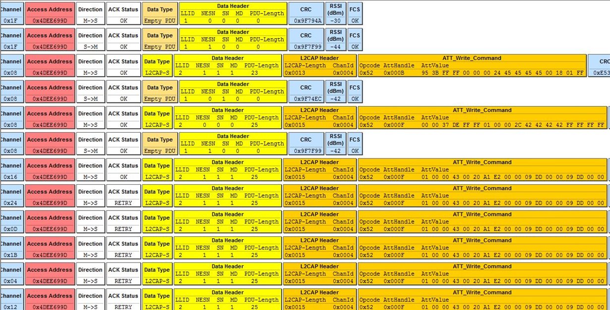

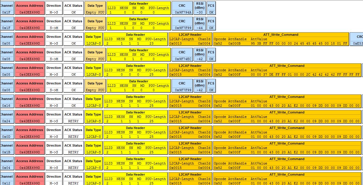

  • Hi Cetri,
    The peripheral is not doing anything else. I have used the default code as in SimpleBLEPeripheral.c
    I have attached the screenshot of the packet sniffer.
    What I had observed is, the same packet it was trying to send from packet no 1754 to packet no 1852 but no ACK status OK was got, instead it was getting ACK status retry
    What does this means?
  • Hi Abhijeet,
    How did you make the image? I thought you were doing "On-chip" OAD, but the header shown in sniffer log indicates that it has the UID "EEEE" which is for "Off-chip" OAD.
    - Cetri

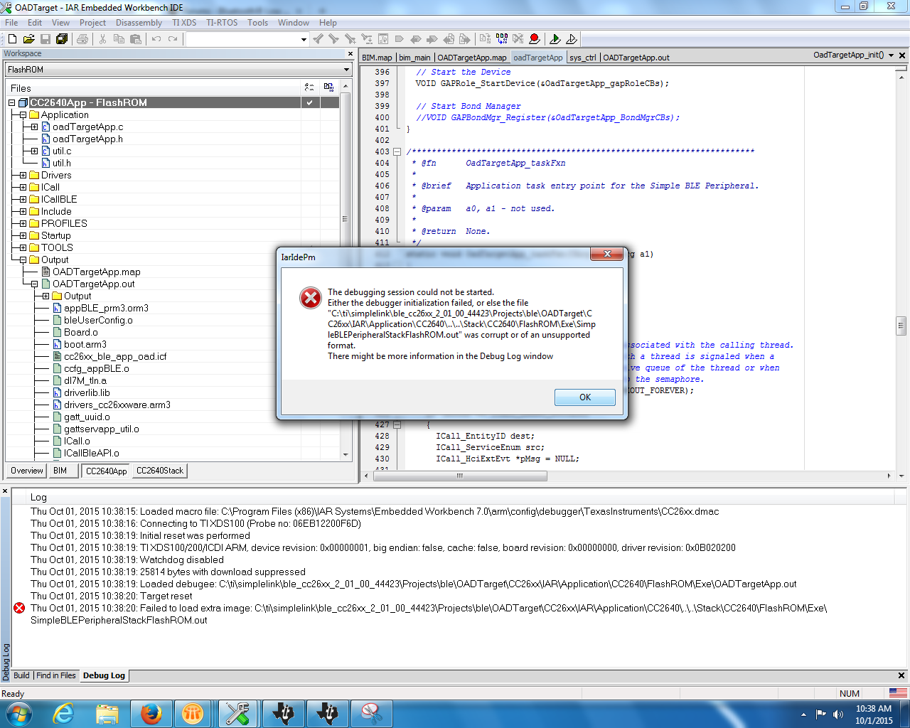

  • Hello Joakim,
    Yeah, I am sure that the image running is new one. (Verified by adv data which is different in both the images)
    And I am unable to do a debug session. It shows the following error when I start a debug without download after flashing the oad_merge.hex from SmartRFFlashProgrammer.
    How to start a debug session for this?
    It seems like it can't find the SImpleBLEPeripheralStackFlashROM.out, which should be available if you compile the stack code. However, the stack code outputs "OADTargetStackFlashROM.out".
    So you will need to go into CC2640App -> Options -> Debugger -> Images -> download extra image: Path
    here, change to right file (OADTargetStackFlashROM.out)

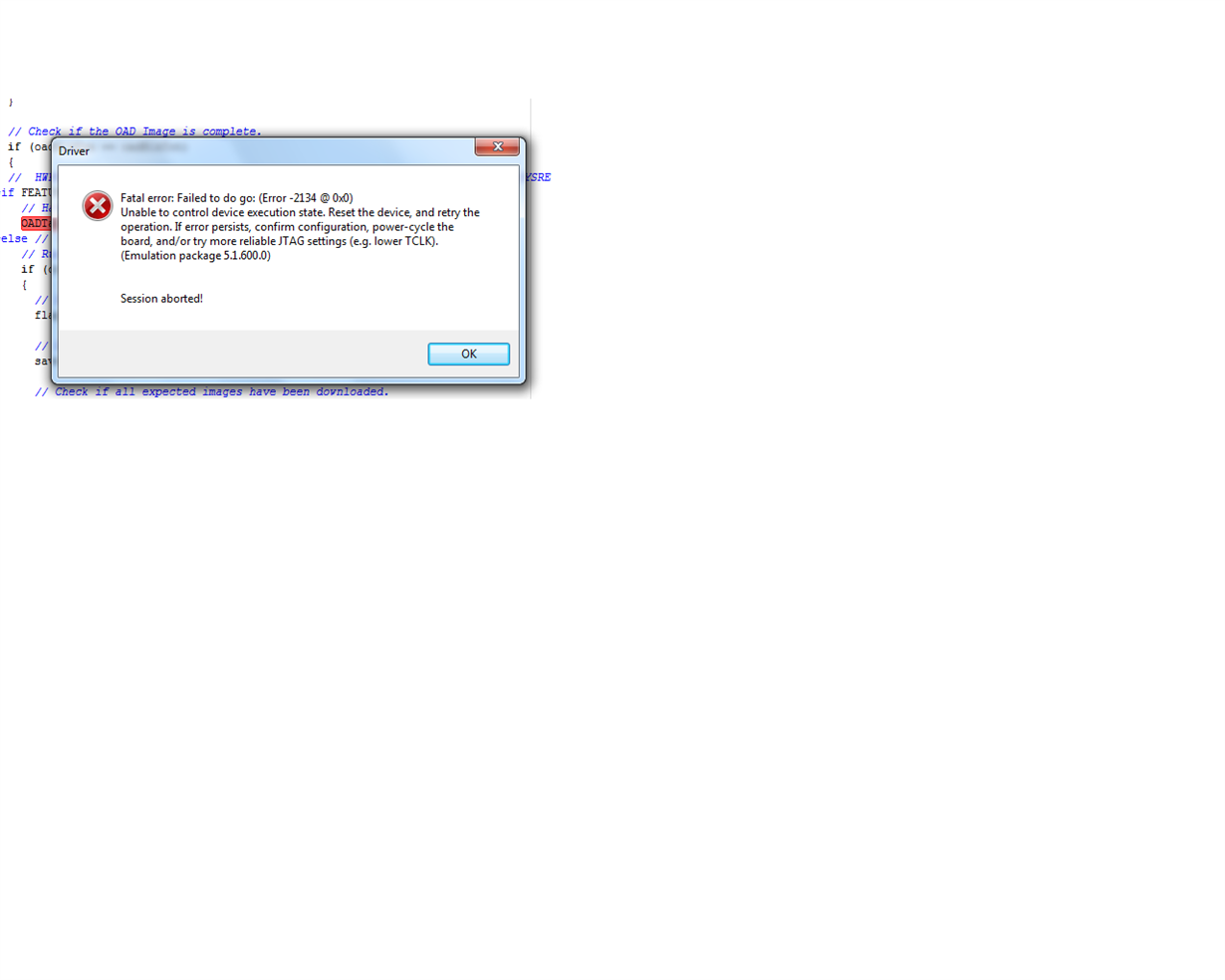

  • Hi Joakim,
    I am now able to do debug session. Thanks for the help.
    It is even coming to the break point where OAD is complete as shown in below screenshot.
    But after executing the next statement, the debug session stops
    But still the the new image doesnt starts immediately.
    I need to give hard reset manually. Then only it starts advertising.
