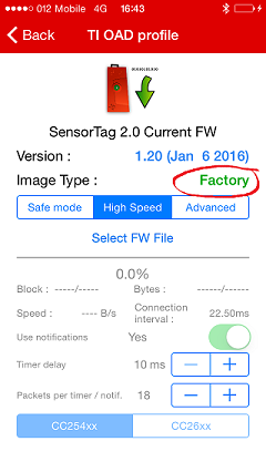

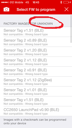

I open the TI sensorTag App, and connect.  Wanting to download the .bin image
I  go to the FW Download Menu (I have OAD Enabled).
I go to the select FW file menu, and see a lot of disabled files.
The heading says FACTORY IMAGES FOR UNKNOWN (See image below)
I am expecting FACTORY IMAGES FOR SENSOR TAG 2
Question:
My question is what does the TI SensorTag App look for to identify the sensorTag 2.0?.
Probably I have made some changes that makes my version unrecognizable to the App, thus not allowing me to download
files as I expect. ( Also my image is always recognized as a Factory Image in Image Type: in the TI OAD profile screen (See image below))

  • Hi Sean,
    Sorry, but this is not what I am seeing.
    I have successfully created a .bin file(bim +app + stack) and have downloaded it to a clean sensortag, running version 1.2.
    The download was succesfull and I can reconnect using the TI iOS sensortag App.->This means that my .bin file is OK.
    The problem begins when I try to download again. As I said I am trying to check the OAD functionaliy in
    my image. Thus on a target running my image I am trying to download again the .bin file.
    After connecting to the device.
    What I see are the screenshots I have attached.
    1. On the "TI OAD Profile" screen. I would expect to see Image Type: "-" and not Factory.(See attached in thread)
    2. On the screen "Select FW to Program" it  says Factory Images for Unkown(I circled it).I think this is a symptom to the problem.
    2. I would also expect to see in the "Select FW to program"  the sensortag version Sensor Tag 2 v1.20(BLE) enabled for download, but it is grayed. And not
    Not compatible: wrong board type.
    4. My .bin file can be choosen(note: not seen in the screenshot) When I chose my .bin file to download I recieve the following message:
    "Wrong image type !"
    "Image that was selected was of type: B, which is the same as on the periperhal...."
    I believe the image running (my image) on the target is not recognized as a sensortag board image.
    Causing the TI iOS App to behave differently.
    As I said my project is derived from the sensortag project. I might have changed something in it
    that causes the sensortag App(now running my image) not to recognize my running image as a valid sensortag board image.

  • Hi Tamir,
    Do you have FACTORY_IMAGE defined in your firmware image that you are preparing for OAD?
    Second, I believe that the iOS application does use the advertisement data to determine if the device is a sensortag. This should not matter as the OAD process doesn't worry about the device. There are no flags in the board file, etc.
    I dont have FACTORY_IMAGE in my project. I disabled it.
    I understand that it copies the current image into external flash if one doesnt exist.
    Do I need it?.

    I apologize that you are still seeing issues. I have attempted the procedure that I detailed in my last comment multiple times and had success. So there is still a discrepancy somewhere. After successfully downloading an image without BIM to the device, can you attempt to attach the debugger (attach to running target) and see where the execution has failed or maybe step through the BIM code.
    I can at least explain one thing, it seems that the mobile app identifies any image that contains the full flash ranage (page0-31) as a factory image.

  • Hi Sean,
    I find a similar problem with Sensor Tag App ver 4.4. I think this problem is a bug on App
    if I change name of device, Image Type on App will be Factory.
    Example:
    I will change "SensorTag 2.0" to "SensorTag 1.0"
    static const uint8_t attDeviceName[GAP_DEVICE_NAME_LEN] = "SensorTag 2.0";
    => static const uint8_t attDeviceName[GAP_DEVICE_NAME_LEN] = "SensorTag 1.0"
    Please check this problem.
    Vy
