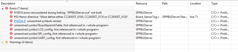

I am just trying to build the SPPBLEServer project and did all the necessary steps mentioned in the support document like copying the files to their corresponding locations in simplelink.  Below are the errors which I couldn't get through. Can you please help me with the issue?

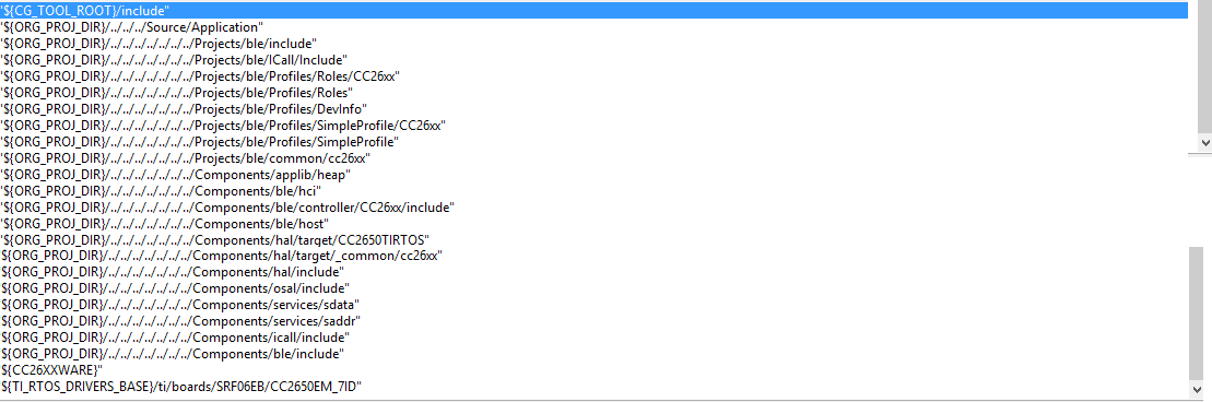

  • Did you also modify the search path?
  • I haven't, but just checked it out and it is proper. Attaching the picture of it for your reference.
  • Can you show me the folder under startup? and open your board.c file, find the #include <Board.h>.
    right click on the board.h, and pick Open Declaration to see which board.h is actually included in your project.
  • Hi Christin,
    Yes, that was the problem. Both the boards were included and I excluded the sensortag board from build.

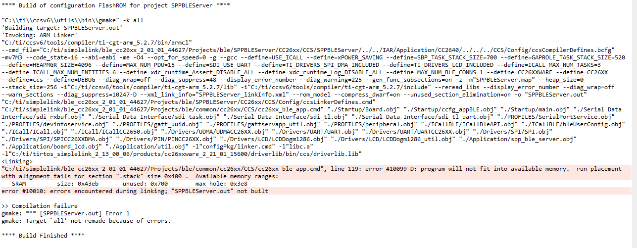

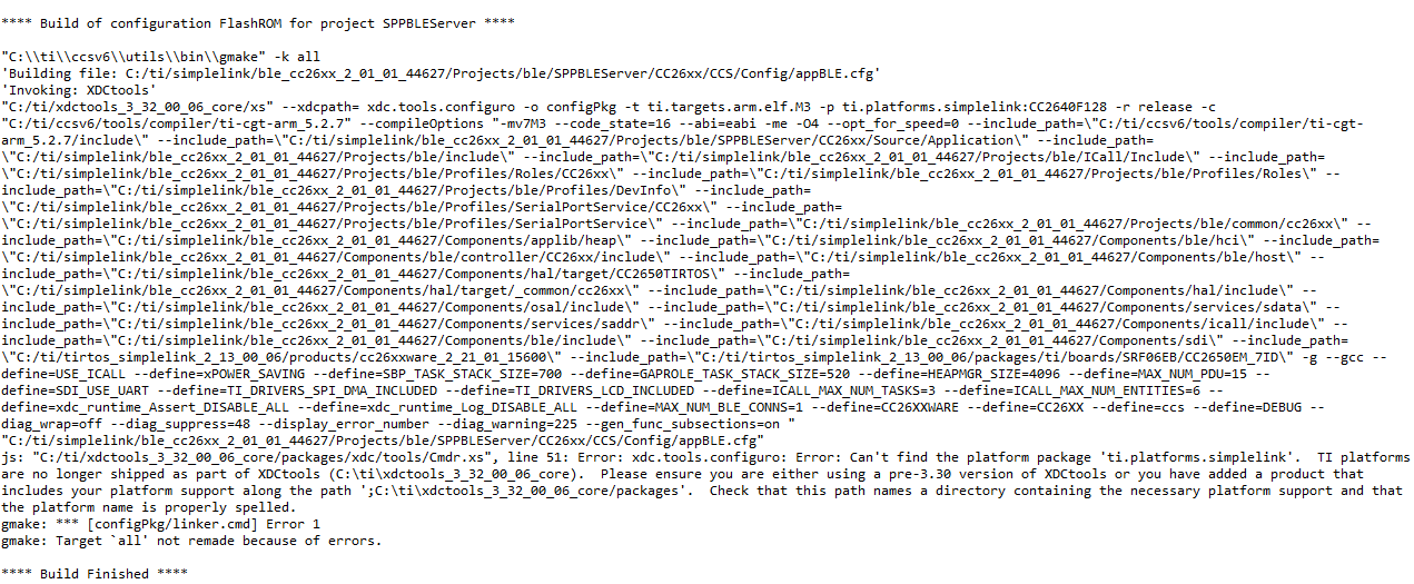

    But now, make file error 1 appears. Attaching the build log for reference.
    Initially xdctools_3_31_01_33_core folder was empty in the ti folder. I downloaded the same xdctool and replaced the empty folder with new one.
    Venkatesh

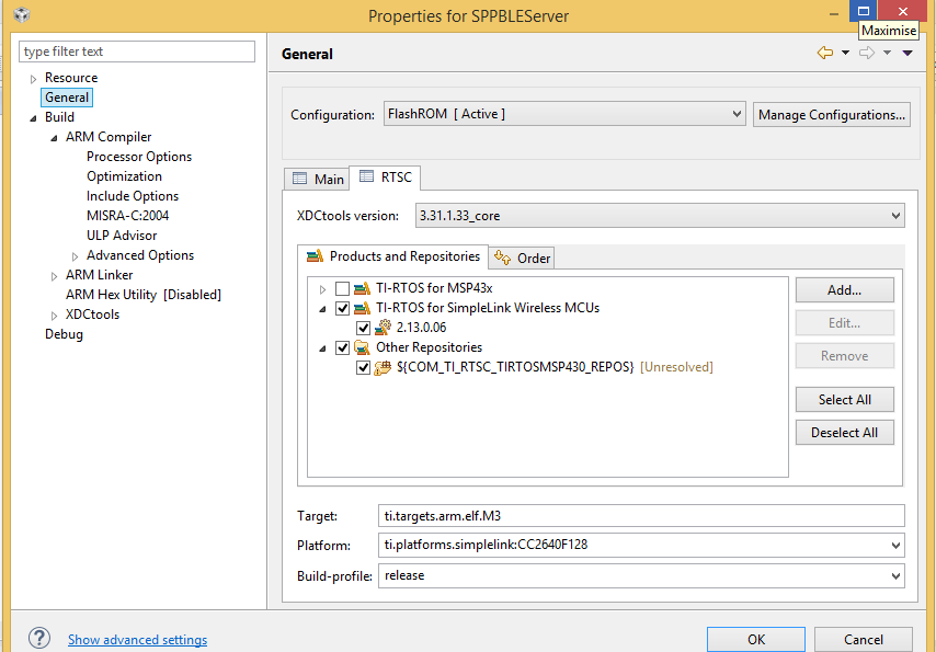

  • Can you show me the general setting of your project? The log you posted shows that the project is set to use XDC 3_32_00_06 version
  • Hi Christin,
    Yes, I am also trying to change it to xdc3_31_1_33 version. Below is the picture for the corresponding settings.

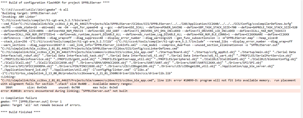

  • And when I tried to build with above shown settings, this is the error I encountered with
  • Try to rebuild both stack and application and see if you still have problem.
  • Hi Christin,
    I tried to rebuild both stack and application but the same error is still there.
    Venkatesh
  • Did you modify anything else in the project? I don't have that problem in my own setup.
    Can you post your cc26xx_ble_app.cmd file here?
  • No, I haven't changed anything else in the project. Here is the cc26xx_ble_app.cmd file

  • Hi Christin,
    I did a fresh installation of simplelink and copied the patch files to make sure that the project files are not modified, but the error remains same.
    Wondering if there is any solution for the issue.
    Venkatesh
    You can reduce the heap size from the application side to make the project fit into the memory.
    The heap can be changed in pre-defined symbol as shown below.
    HEAPMGR_SIZE=4096
    Please take a look at our software developer's guide section 9.10 and 9.6
  • Hi Christin,
    I tried to reduce the heap size but I ended with the same result.
    Instead, I modified ICALL_STACK0_ADDR and ICALL_RAM0_ADDR as mentioned in this thread ( e2e.ti.com/.../477933 ). It worked perfectly.
