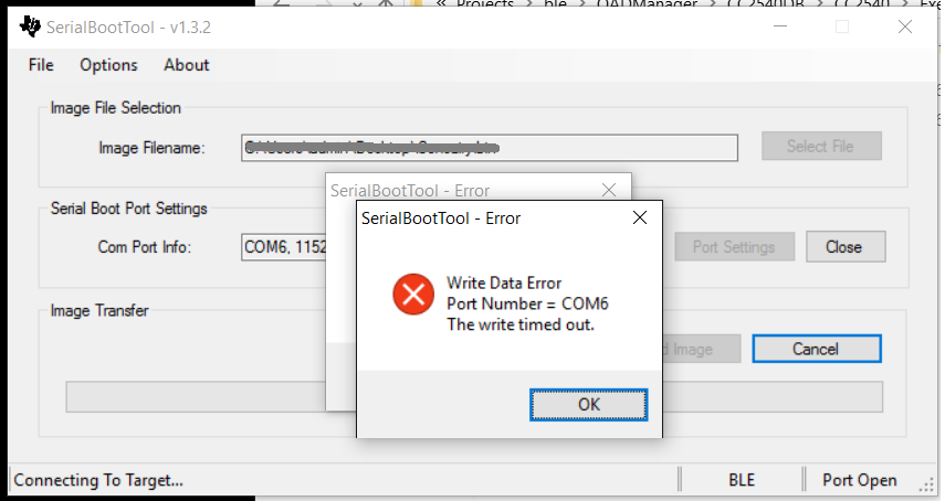

I loaded the OADManager built using BLE stack 1.4.2 for CC2540 into a CC2540 board mounted on the smartRF05EB. When reset, I press the joy stick down and the screen shows SBL mode.
Here I try to load a bin file using serial boot loader 1.3.2 and hit the write error. Please find the attached images. I tried with BTool for the same smartRF05EB and it is working fine. So issue is not with the board or serial port.

    Are you able to verify that the SRF05 is present on COM6? Make sure the RS232 switch is enabled, additionally be sure that the EM selection is set to SoC/TRX.
  • Hi Tejas,

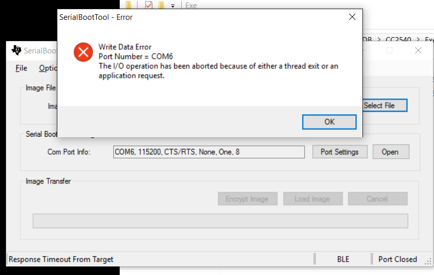

    Fortunately your last screen grap shows the COM port settings. Can you try disabling CTS/RTS and set to None. The SBL does not enable HW flow control.
    Best wishes
    @Sean: Yes. SRF05 is present on COM6. In device manager, I can see this. RS232 switch is enabled. But EM selection was set to MSP.
    I made the following changes
    1. EM selection is set to SoC/TRX
    2. Flow control set to None
    I encounter the error shown in screenshot-2 i.e `Device Command Response Timeout, Operation State = Handshake`
    I changed the flow control back to CTS/RTS and the same errors occur as before. (Screenshot-1, 2 and then 3)
