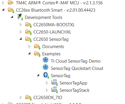

i downloaded the new CCS6.2 version 50 and install BLE Stack 2.2.
The CCS6.2 Resource Explorer doenst import the BLE STack 2.2 examples into it.
So i went and imported per hand to my workspace.
Problem is that i can flash the stack for example and afterwards i cannot flash anything anymore.
If i import the examples from the resource explorer it works fine.
I used the flash programmer 2 and program the .hex files from stack-app-bim and that worked.
So i think there is something wrong with CCS6.2
I also did the workaround from the 4.8 version and replace the .dll file provided from TI.
Is there any issue know about CCS6.2 version 50 and BLE Stack 2.2 example projects?

  • Hi Rebel,
    i have the CC26XX Device Support version 2.0.1.00 installed. The target board arent changed and the linker command file is empty. So there is only one linker and not twice on the project.
    Are the examples you tryied from the BLE Stack 2.2?
    Did you import it manually to CCS? On Resource explorer i have also examples but from older stack and they all work too like this one:
    Bu i want to use the project examples from BLE Stack 2.2 from here:
