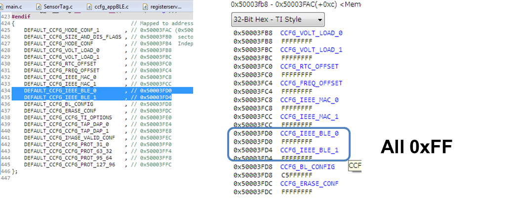

1) Buy unique address from IEEE.
2) Program above unique mac address to Customer Configuration (CCFG) of each device.

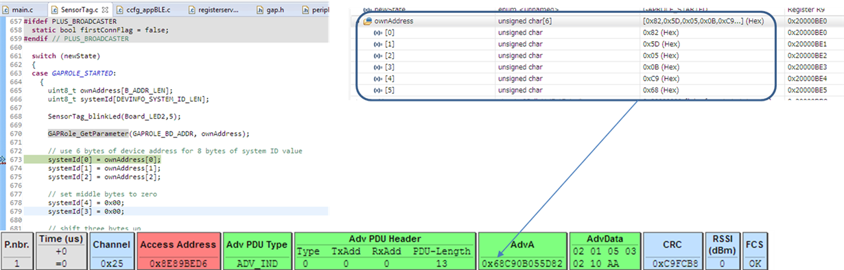

* Currently the area of sample code like SensorTag is written all 0xFF. When I read BD address using GAPRole_GetPrameter, the vale is 0x68C90B055D82.
Since this is NOT random address with Tx Add =0 in Adv PDU Header, I guess that BLE stack automatically generate this address inside. If my understanding is not correct, would you correct me?

Is it necessary to set unique address bought from IEEE at 1st start up when our customers start mass production?
Currently BLE stack automatically seems to generate unique address due to 0xFF value of Customer Configuration (CCFG).
If 0xFF is not written in CCFG, does BLE stack stop to generate unique address and then can they activate with unique address written in CCFG?

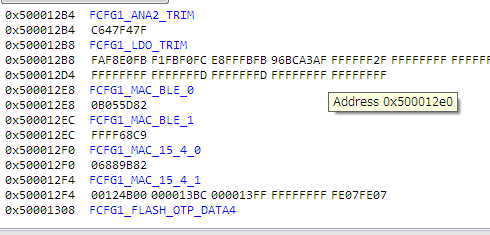

  • Hello Koichi,
    The CC26xx is factory programmed with a unique Bluetooth device address by TI. There is no need for you to purchase an address.
    Please see "9.2 Factory Configuration (FCFG)" in the CC26xx TRM (SWCU117).

  • Hi Koichi,
    The memory map is detailed in Sec 3.2.8 Cortex-M3 Memory (Rev F of the TRM).
    Refer to FCFG1 - Factory Configuration Area 1 at 0x50001000.

  • Hello JXS,
    Thank you for teaching.
    According to your suggenstion, checked "AdvA address" at Sniffer.
    and then could verify at "Memory Browser".
