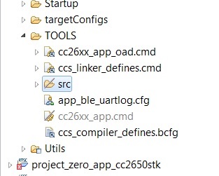

I repeated OAD on simple_peripheral cc2650lp how explained in Over-the-Air Download User’s Guide For BLE-Stack™ Version: 2.2.0 and it works.
But when I try use OAD in Project zero I get an error
<Linking>
"c:/ti/simplelink/ble_sdk_2_02_00_31/src/common/cc26xx/ccs/cc26xx_app.cmd", line 98: error #10264: FLASH memory range overlaps existing memory range IMAGE_HEADER
"c:/ti/simplelink/ble_sdk_2_02_00_31/src/common/cc26xx/ccs/cc26xx_app.cmd", line 98: error #10263: FLASH memory range has already been specified
"c:/ti/simplelink/ble_sdk_2_02_00_31/src/common/cc26xx/ccs/cc26xx_app.cmd", line 98: error #10264: FLASH memory range overlaps existing memory range FLASH

"C:/ti/simplelink/ble_sdk_2_02_00_31/src/common/cc26xx/ccs/cc26xx_app_oad.cmd", line 125: error #10099-D: program will not fit into available memory. placement with alignment fails for section ".const" size 0x1c10 . Available memory ranges:

This error in the "cc26xx_app.cmd" file, but I exclude the file from the compilation.
p.s. I'm sorry for my English
  • The problem was solved when I selected Project→Properties→Build→ARM Linker→File Search Patch and deleted "${TI_BLE_SDK_BASE}/src/common/cc26xx/ccs/cc26xx_app.cmd"

    Just for people who find this thread in the future - the issues Roman got were due to the linker including the cc26xx_app.cmd file multiple times.

  •  Project→Properties→Build→Link Order
    Here is important the order of files: 1)TOOLS/ccs_linker_defines.cmd 2) TOOLS/cc26xx_app_oad.cmd

        I followed that part of the guide. I had to change "${SRC_EX}/profiles/oad/cc26xx" to "${TI_BLE_SDK_BASE}/src/profiles/oad/cc26xx". After that it build without errors. Then I proceeded to add the changes you mentioned in this post. After that I got all this build errors and warnings. Any ideas what could have caused this? My initial guess is that I should exclude cc26xx_app.cmd from build.

        I exclude to build src folder and cc26xx_app.cmd and the errors go away. I will test OAD when I receive my TI BLE USB Dongle next week.
