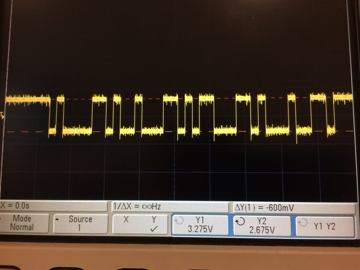

    I've already read this , but my problem is rather gpio config than UART config.
    I think i'ts a basic thing but I don't know what is the problem. I figured that the msp430 can't pull down the cc2650's rx pin,only to 2.7 V. The level of logic one is ok,3.3.
    On scope I've got this:
    I've already read the MSP430's and the CC2650's manual and I set PULLUP, PULLDOWN, etc. on both sides but still nothing. If I put the cc2650's rx  directly to the ground ,the interrupt works and with PUTTY it is also working ,so I'think it is a PIN problem as I mentioned before.

  • Hi Mayer Tamas,
    Do you connect to DIO2 and DIO3 directly? If you connect to DIO2 and DIO3 directly, you should remove the jumper on TX and RX on LAUNCH Board.
