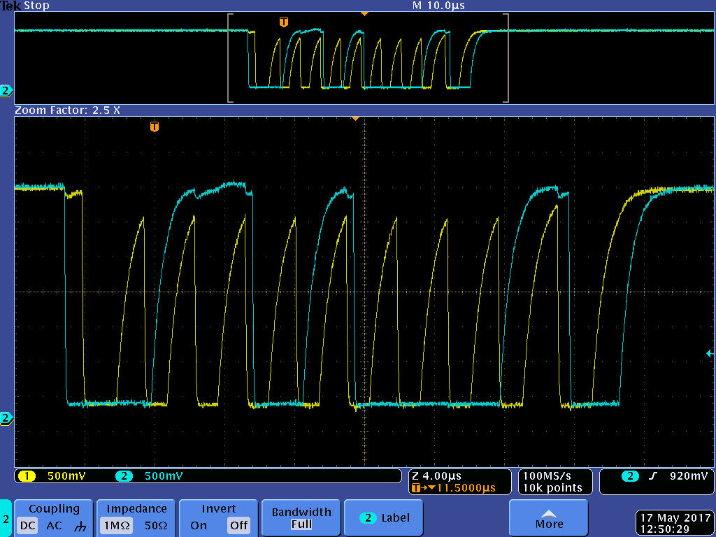

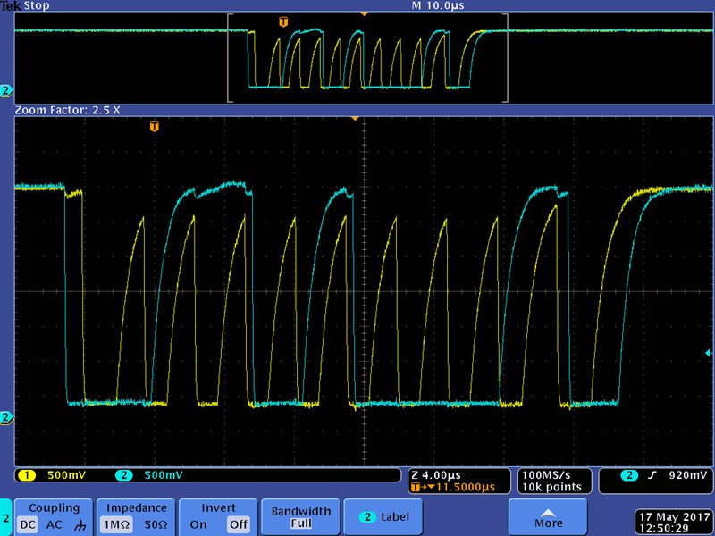

  • Here is a picture from the scope:

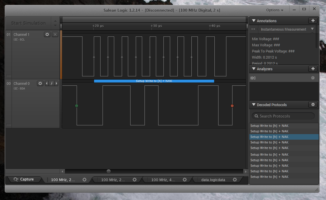

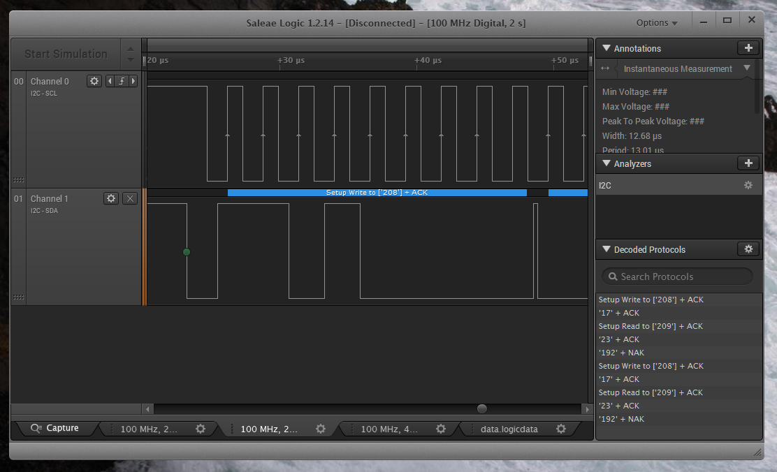

  • Here is another screenshot, but using a digital probe.
  • Hello Roman,
    Perhaps the pull-up is too weak?
    The TI-RTOS driver you succeeded with will configure internal pull-up on SDA/SCL. The sensor controller framework will not configure any pull-up. You can hack/alter this in the framework function scifTaskResourceInit():
    scifInitIo(9, AUXIOMODE_OPEN_DRAIN_WITH_INPUT, -1, 1);
    scifInitIo(10, AUXIOMODE_OPEN_DRAIN_WITH_INPUT, -1, 1);
    By changing the third argument to 1:
    scifInitIo(9, AUXIOMODE_OPEN_DRAIN_WITH_INPUT, 1, 1);
    scifInitIo(10, AUXIOMODE_OPEN_DRAIN_WITH_INPUT, 1, 1);

    It turns out the problem was the I2C slave address I was using.
    In Arduino I used 0x68, in RTOS I used 0x68, and hence also used it here. In hindsight it's obvious but I should have done 0x68 << 1. I figured it out by using the digital scope on the Sensor Controller version and the RTOS version and comparing the two.
    Figure 1: 0x68 address in sensor controller
    Figure 2: 0x68 << 1 address in sensor controller
