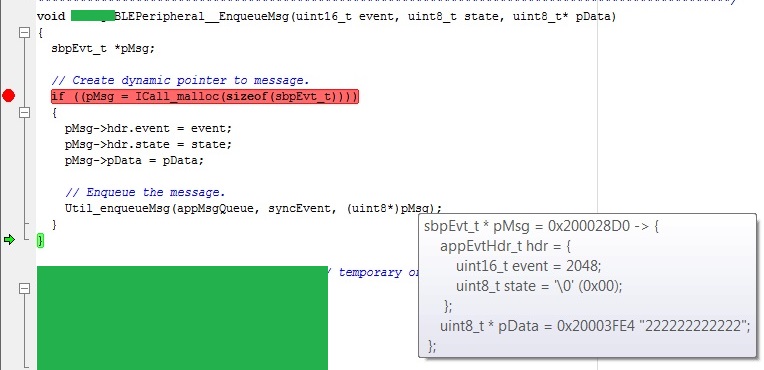

     I am queuing this string "22222222222" at TestApp__QueueWriteTagID(). After Processing the App Message at main Task, the "222222222222" gets erased or corrupted.
static void TestApp__QueueWriteTagID(BYTE* msg)
    uint8_t *pData;
      // Allocate space for the event data.
    if ((pData = ICall_malloc(sizeof(uint8_t))))
        pData = msg;
        XXBLEPeripheral__EnqueueMsg(SBP_WRITE_TAG_EVT, NULL,  pData);
    return;
The message is queued at XBLEPeripheral__EnqueueMsg(). As you can see the "222222222222" is stored at pData.

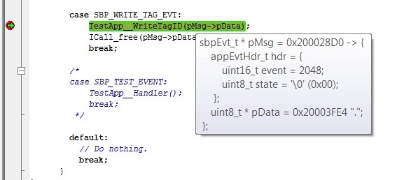

At XBLEPeripheral__ProcessAppMsg() the "222222222222" gets erased or corrupted.
Why does "222222222222" gets erased?

  • I already made it to work. I allocate just enough memory for the message and then use MEMCPY to transfer msg contents to pData.
        uint8_t *pData;
        if (STRLEN(msg) <= XX_TAG_ID_LEN)
          if ((pData = ICall_malloc(XX_TAG_ID_LEN + 1)))
              MEMCPY(pData, msg, STRLEN(msg));

  • Ok, good. I was starting to think it was another double pointer issue :)
