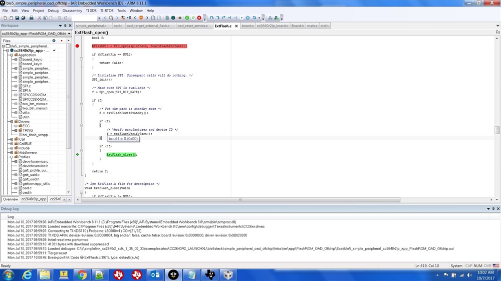

         I debug the code, and it return 0 at extFlashVerifyPart(). See, below.
    - kel
  • Hi JXS,
    I set the Optimization Level from High to None and was able to do OAD. The downside is that the App OAD image size and download time has increased.
