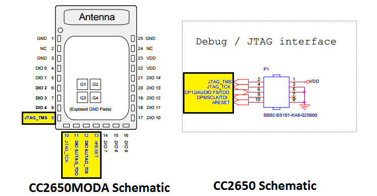

Now I am want to use CC2650MODA and wish to upload hex files that I have generated.
From schematic I found that I can connect JTAG TMS, TDI, TDO TCK, nreset, VDD and Gnd (Please find attached image for schematic reference).
My Question is
1. Except this, what else I have to do in CodeComposerStudio ?
2. How can I change board-type to CC2650MODA?

  • Thanks for your quick answer. :) But still I am facing error popup: (Please find attached screenshoot)
    Error connecting to the target:
    (Error -242 @ 0x0)
    A router subpath could not be accessed.
    The board configuration file is probably incorrect.
    (Emulation package 6.0.576.0)
    Console output says:
    Cortex_M3_0: GEL Output: Memory Map Initialization Complete.
    IcePick_C: Error connecting to the target: (Error -242 @ 0x0)
    A router subpath could not be accessed. The board configuration file is probably incorrect. (Emulation package 6.0.576.0)
    Following is process which I followed :
    1) Opened project from path ble_stack_path    -> \examples\cc2650em\simple_peripheral\ccs
    2) Changed board file from path ble_stack_path    -> \src\boards\CC2650_LAUNCHXL\CC2650_LAUNCHXL.h
    Please find attached file, which I am using.
    3348.CC2650_LAUNCHXL.h
    3) Connected XDS110 (Default debugger from sensortag) with CC2650MODA as shown in attached image.   (Please find attached zip folder for images)
    4) Click on Build Stack, (Build successfully) and click on debug.
    ---- Error occured
    Please let me know, if I am missing something, need urgent help for my project.
