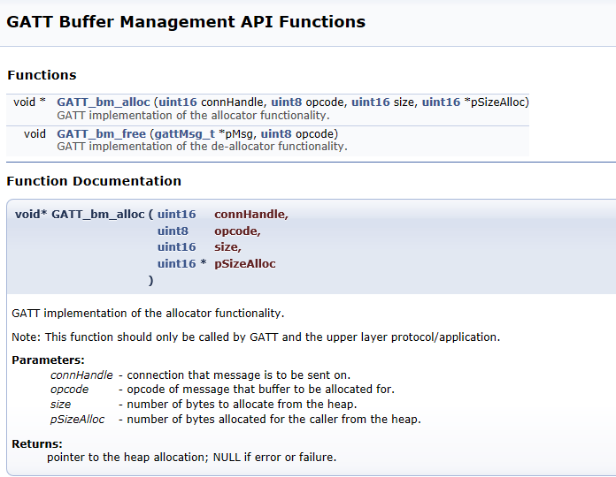

CC2540: Will the memory allocated by GATT_bm_alloc be released automatically while successfully calling GATT_Notification?
Part Number: CC2540
I'm coding to test the GATT_Notification function according to below example. But found that the example didn't release the allocated memory after GATT_Notification is successfully executed. But when I wrote a test code to notify automatically every 100ms, and found that no error occurs, and the heap is still having enough space. So the question is, can I see the allocated memory will be released automatically and no need to release manually?
So I'm guessing the GATT_Notification function could release the memory automatically. But I've not found any reference since TI's GATT manual didn't say a thing about it.
This is really an old chip, so many thanks that if anyone could help me to clarify it.
  • Hi Weichen,
    Please see the Memory Management for GATT Notifications/Indications section (Section 7.6.1) )of the TI BLE Software Developer's Guide for information about how memory is freed for notifications/indications.
  • Rachel,
    Thank you so much for your help. It helps.
    The Software Developer's Guide's already pointed it out and I should read it carefully. And I'm posting the text below for other guys to refer.
    7.6.1 Memory Management for GATT Notifications / Indications
    The preferred method to send a GATT notification / indication is to use a profile’s SetParameter
    function (i.e. SimpleProfile_SetParameter()) and call GATTServApp_ProcessCharCfg(). If using
    GATT_Notification() or GATT_Indication() directly, there is additional memory management needed:
    1. Attempt to allocate memory for the notification / indication using GATT_bm_alloc().
    2. If allocation succeeds, send notification / indication using GATT_Notification() /
    GATT_Indication().
    3. If the return value of the notification / indication is SUCCESS (0x00), this means the memory was
    freed by the stack. If the return value something other than SUCCESS (i.e. blePending), free the
    memory using GATT_bm_free()
