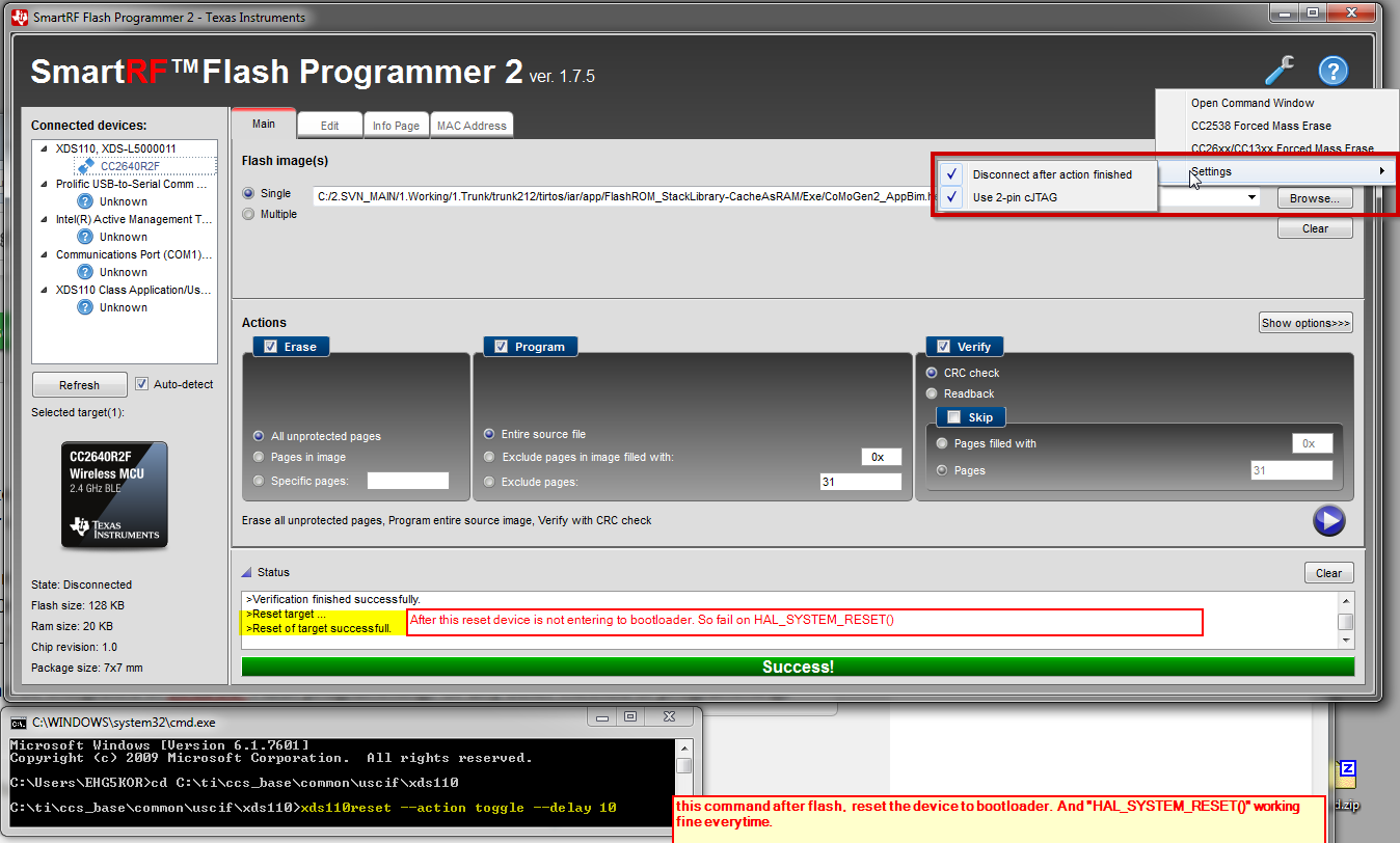

    2.Same behavior observed even from Flash programmer  2 ver 1.7.5
    I observed that any of above programming method is not going to reset it to boot loader.
    So I used "xds110reset --action toggle --delay <delay>" and observed that device is reset and enter to boot loader.  And HAL_SYSTEM_RESET() is working fine every time.
    How this reset can be integrated in SmartRF Flash programming? Or any other method of programming?

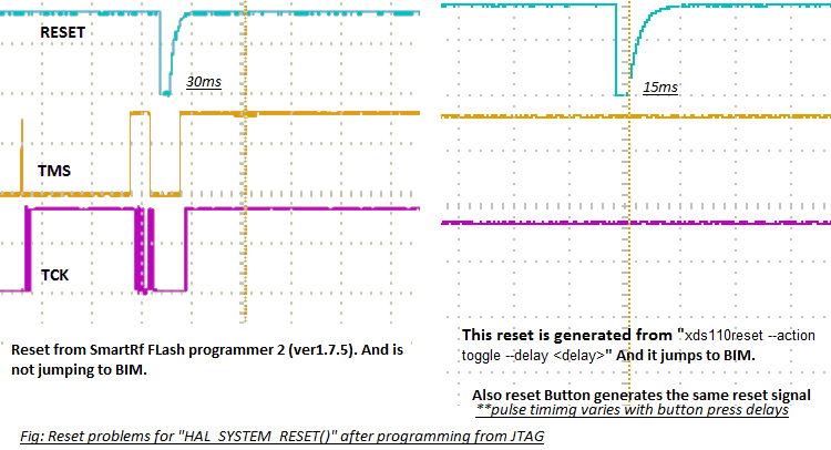

  • Hi Sean,
    I also monitor the Reset line. And I found different reset wave forms with TMS and TCK.
    Could you please explain what happens to reset in first (waveform) reset condition?.
    How can I achieve the reset which jumps to BIM using SmartRf Flash programmer?
    The waveforms you have shown correspond exactly with the Halt In Boot (HIB) state described in the TRM, section 5.6
    This is related to the version of the Emupack that is used by SmartRF flash programmer 1.7.5. I am not sure if it is possible to point it to another version of hte Emupack. I will ping the developer for details.

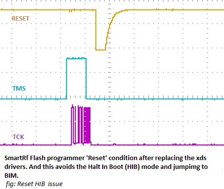

  • Hi Sean,
    Thanks for the solution.
    I have replaced xds drivers inside <fp2_install_dir>/config/xds/* and  HIB avoided.
    Below is the reset waveform from SmartRf Flash programmer.
    Niranjan Hegde
