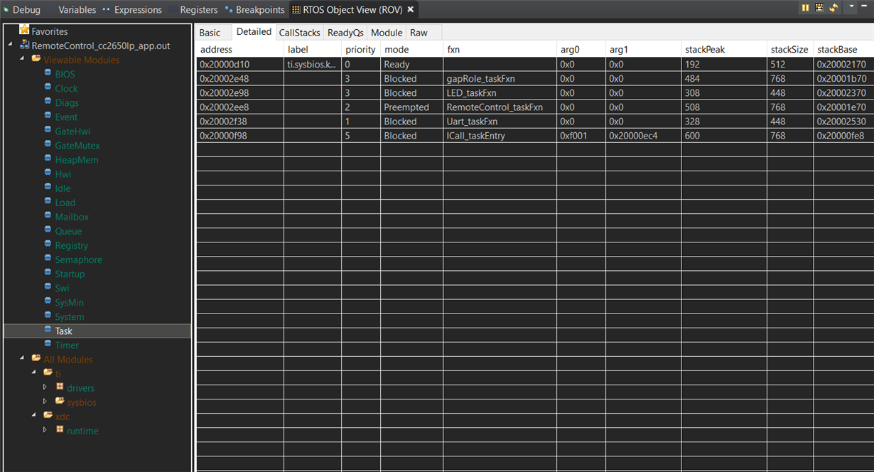

Task Stacks at time of exception:
Exception details: (I also checked the CFSR both at entry to my exception handler, and at entry to the exception handler in ROM, all 0's both times...I don't understand whats raising the exception)

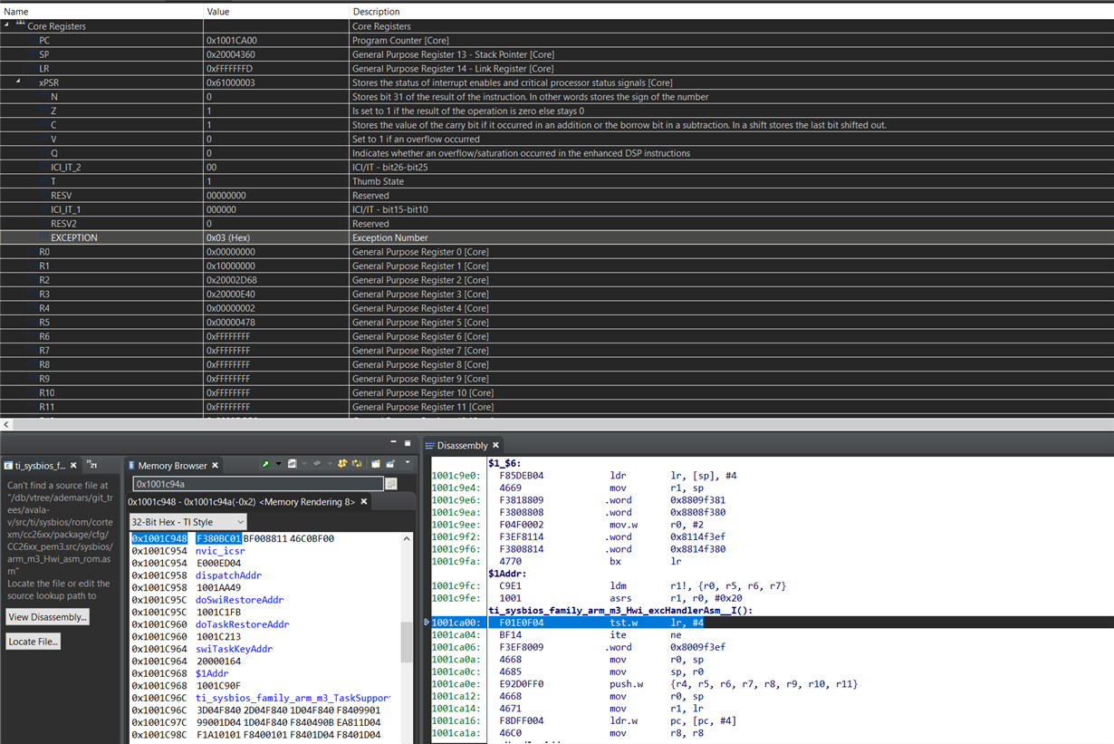

    3). I set a breakpoint at 0x1001bbc8, which I think is the ROM code exception handler, that eventually calls my app exception handler. I checked the CFSR at this breakpoint and the CPU isn't reporting any exceptions, it's all 0's. Is the BIOS calling the exception handler for a "soft" fault? A few things to note at this breakpoint:
    a). The exception number in the xPSR register is 0x18, which corresponds to the SS1_COMB interrupt.
    b). The LR is 0xFFFFFFFD, is this what caused the exception? Trying to return to an invalid address?

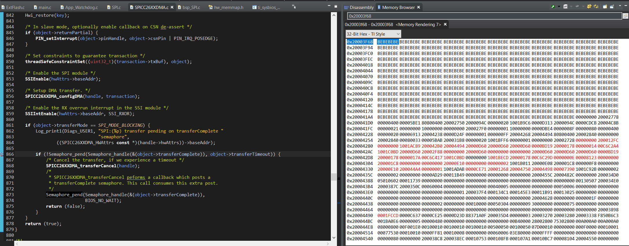

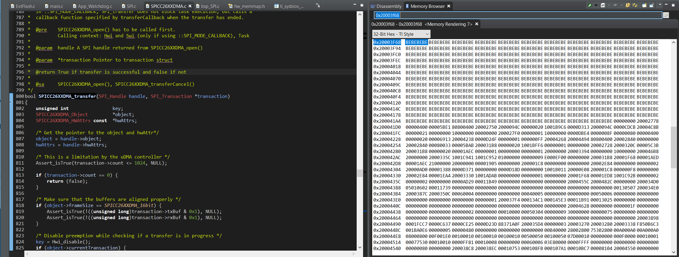

    Right at the beginning of the offending SPICC26XXDMA_transfer() call:
    At the call to semaphore_pend(), you can see the stack has changed quite a but it's below the peak depth it's ever been to:

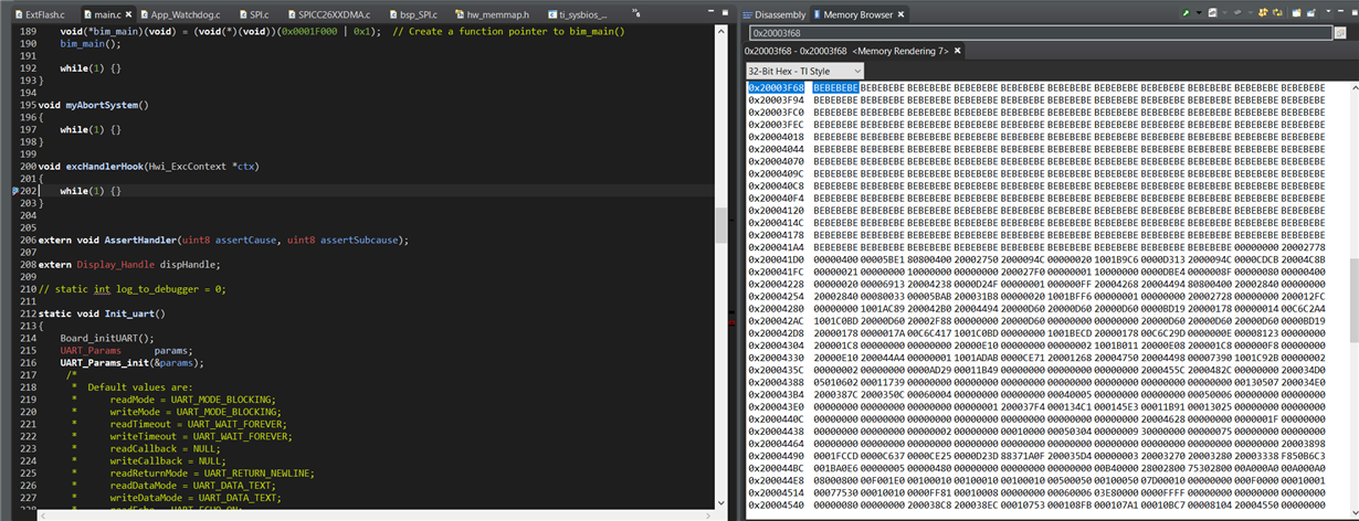

    And finally at the exception hook, nothing has changed on the system stack, which I find somewhat surprising, but I'm not super well versed on what's going on under the hood while that semaphore is pending:

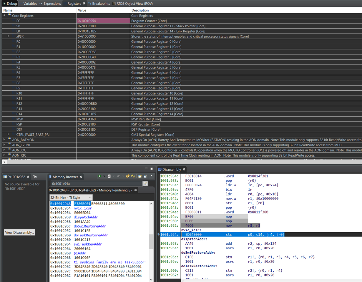

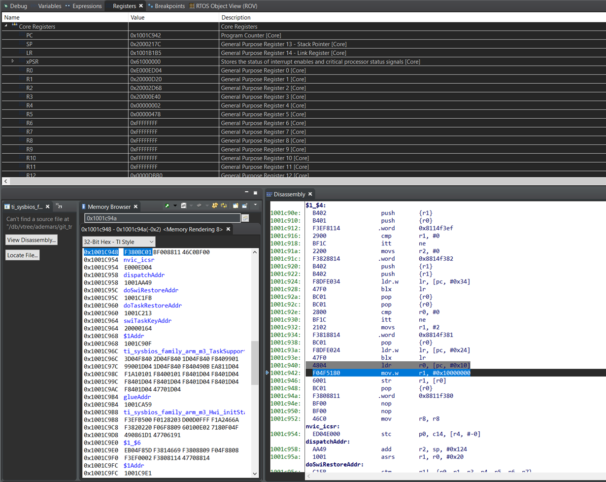

  • Another (not so) brief update before I pack it in for the weekend.
    I've been somewhat successful tracing through what the sysbios ROM code does once the SPI transfer pend's, but I'm still not sure how to fix the issue.

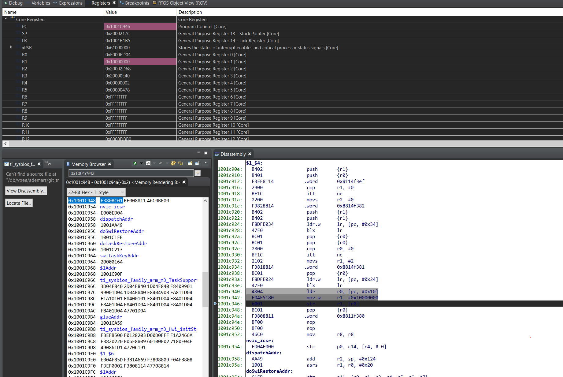

    I've traced it pretty deep and see some things that make sense happen, the "RemoteControl_taskFxn" gets suspended, but the "blockedOn" field in ROV is unknown. After that task is suspended the  scheduler runs and activates the ti_sysbios_knl_idle_loop_E. Eventually, after a lot of assembly stepping I get into the ti_sysbios_family_arm_m3_Hwi_dispatch__I(): function. Towards the bottom of this function the PENDSVSET bit is set to 1 by the assembly code, and the ISRPREEMT bit goes active. I step a couple more times and I end up in the exception handler after the the processor tries to execute the instruction at 0x1001C954.  I'm definitely in a little over my head here, but I don't believe the execution is supposed to make it this far. The value at that memory location is actually the address of the NVIC_ICSR, and is just there to be referenced by the instruction at 0x1001C940.
    Here's some more snapshots from stepping through this section of ROM code:
    I'm not sure if this is actually meaningful, because I get the same behavior when stepping through code with the watchdog disabled, that doesn't trip any exceptions during OTA when I let it run. It seems like an interrupt should happen after the PendSV bit is set, maybe the debugger is interfering? I did take a look at some other registers and the DHCSR.C_MASKINTS bit is cleared/0, so I would think that interrupts should still be serviced even when stepping in the debugger.
    I've looked at far too much assembly today...I'm going to drink some tasty beverages, thanks for the input, hopefully we can resolve this one soon.
    -Josh M
