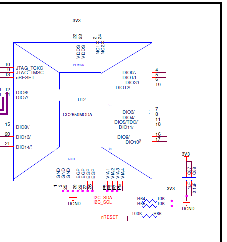

We have designed our custom board using CC2650MODA module. We are trying to program the module through cJTAG connects as described in the swra534a document.
I have connected the 100K resistor across Reset and 3V3 as described in the document. I am getting the following error when I debug the code.
Error connecting to the target:
(Error -242 @ 0x0)
A router subpath could not be accessed.
The board configuration file is probably incorrect.
(Emulation package 6.0.579.0)

What else should I change to debug the code?
