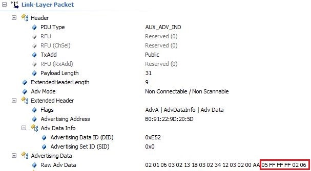

I am trying to update one part(actually rear part with 5 bytes long) of the AdvData array at any time when needed by using  GapAdv_prepareLoadByHandle & GapAdv_loadByHandle.
As usual, it works well, but sometimes, the AdvData has a little bit what I didn't mean, that is, the rear part of the AdvData has garbage data I didn't update.
This case happened where 125Kbps PHY packet is being used, while 1Mbps PHY packet didn't.

The below shows a wrong case I didn't want.
The below shows the normal case I expect.

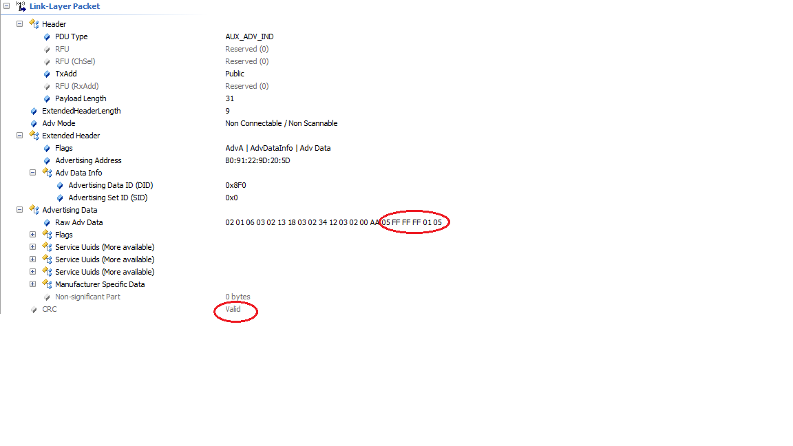

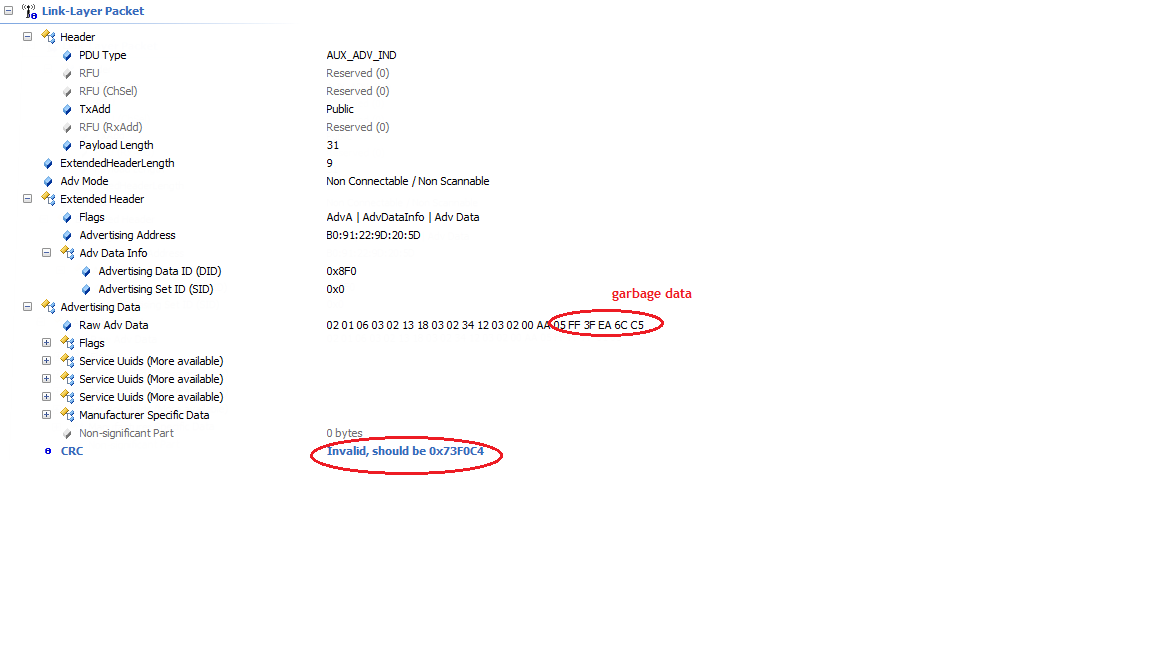

  • Thanks Zahid,
    Even though I utilized what you posted, but the result is the same one as I had.
    Please refer to the below captured picture.
    In normal case, there is no CRC issue and the manufacturer specific data is right.
    But, in wrong case, it has the CRC error and garbage data.
    Thanks a lot for your support.
