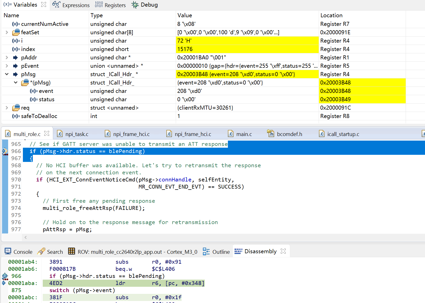

             I in NPI folder add npi_frame_hci.c file and in Predefind Symbols  reivse ICALL_MAX_NUM_TASKS= 3 update ICALL_MAX_NUM_TASKS=4 build OK, download CC2640R2F launchPad running ok ,iphone can find multi_role broadcast,iphone LightBlue App to connect Multi_Role ,can't connected,
     Debug multi_Role project pls see image:
          Justin
