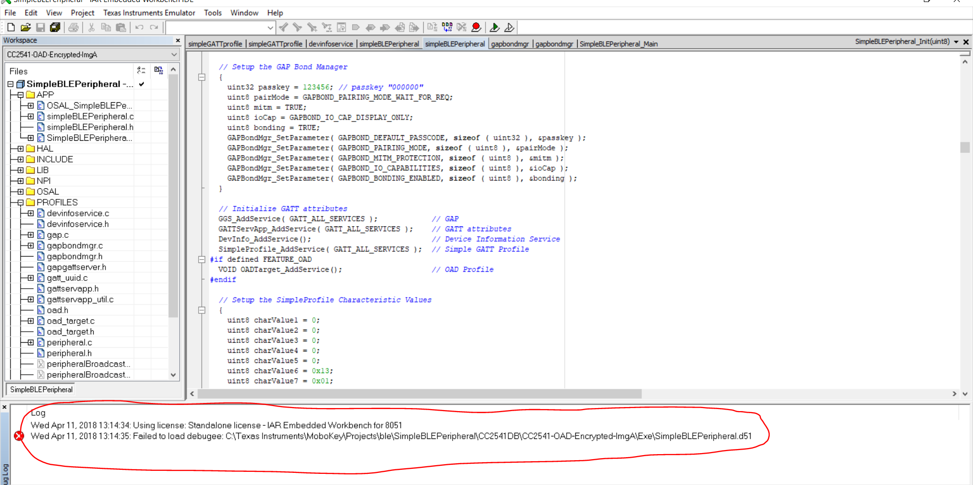

    I am working on cc2541 OTA (CC2541-OAD-Encrypted). I am following Over-the-Air_Download_for_CC254x.pdf. I am creating CC2541-OAD-Encrypted-ImgA.hex file
    When i built the code these three files created.
    1-SimpleBLEPeripheral.bin
    2-SimpleBLEPeripheral.d51
    3-SimpleBLEPeripheral.sim
    But I need hex file to create super hex file for OTA.

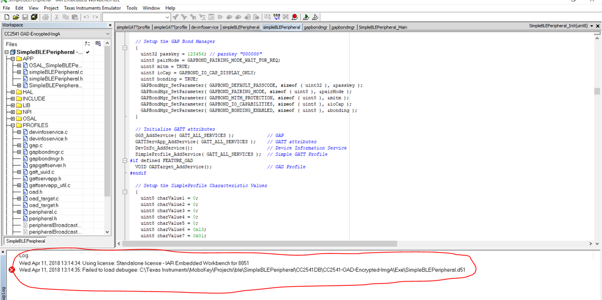

    I also get this error when i debug and download.
    How can I fix that ? Its urgent kindly reply.
  • Which IAR version do you use? I can build the same project without problem using IAR EW8051 v9.10.
