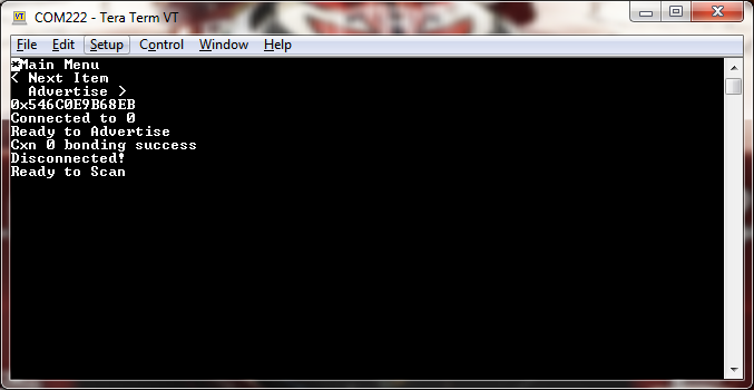

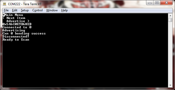

    Using the V1.50.00 SDK for CC2640R2F, I flashed multi_role without changing any parameters. Opened up a tera term session to interact with it and received the following:
    Here i am connected with my iPhone running LightBlue explorer app. From there, I disconnected from the launchpad and received the following:
    Here you are correct, I am not seeing any advertising, but if I interact with the menu here: I sellected "< Next Item" by clicking the left launchpad button (BTN-1) and then received the following menu:
    From here, I clicked the right launchpad button (BTN-2) to select "Advertise >" and my device started advertising again and I was able to connect.
    Please let me know if this doesn't resolve your issue.
  • PawelN, I believe your workaround is not needed as the architecture of the program is written to require the user to interact with the program via buttons to get it to readvertise. If you look into this action, on a connection terminate event you can just ask the device to immediately start advertising again, but this would take some editing of the multi-role example.
