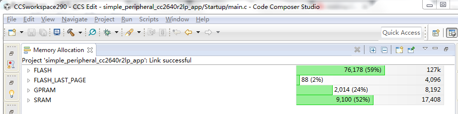

  • 1.When using PIN_getInputValue(CC2640R2_LAUNCHXL_SPI0_SRDY) instead of PTM_ENABLE_FLAG , the code snipper is shown as followed ,  the problem that iphone cannot pair with CC2640 will appear again . The real reason why iphone cannot pair with CC2640 after adding PTM into simple_peripheral project is that SRAM is not enough .
    /********************* main.c ********************************/
      if(PTM_ENABLE_FLAG)
          NPITask_createTask(ICALL_SERVICE_CLASS_BLE);
      if(PIN_getInputValue(CC2640R2_LAUNCHXL_SPI0_SRDY))
    2.This problem can be solved by configuring the CACHE as GPRAM . The official doc in SDK named in 《Cache/GPRAM》 has shown how to configure the CACHE as GPRAM, as shown in picture 1 .Location of 《Cache/GPRAM》 is shown in attachments.
    3.Memory allocation of CC2640 can be seen from "CCS-view-memory allocation", as shown in picture 2.
