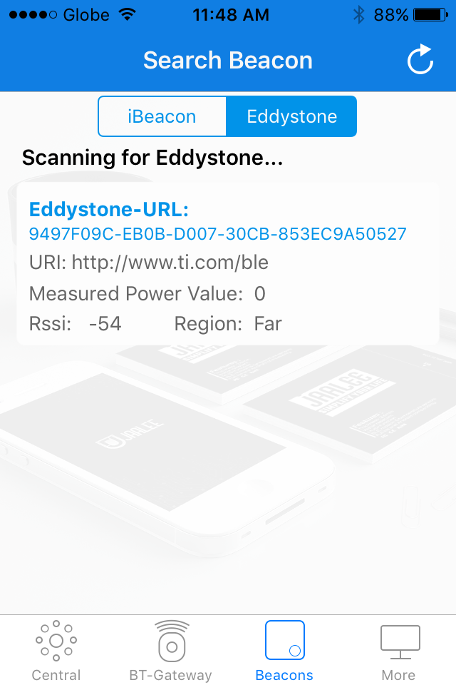

        I do not have a Packet Analyzer to check. I want a Eddystone packet, because my end objective is a Connectable Eddystone Beacon. I thought of copying the advertisement data from Simple Broadcaster to Simple Peripheral.
        At Simple Broadcaster with BEACON_FEATURE nothing appears at eBeacon->iBeacon and eBeacon->Eddystone tab. However using micro eddystone beacon I see this below at eBeacon->Eddystone tab after pressing Button 2. I also used Beacon Manager App for testing and same results.

  • Markel,
    Eddystone and iBeacon are two completely different packet formats and they are not compatible. In order to send Eddystone packets from the Simple Broadcaster, you will need to update the content of the advertised data. The specific code you will need to update is
