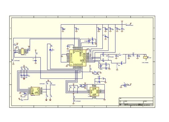

    do u knw how to write  a program for gyroscope?the gyroscope is L3G4200D(MEMS motion sensor:
    ultra-stable three-axis digital output gyroscope)
    if you wan to see de schematic of the gyroscope,u can see it from my profile list

    What you do mean by saying "know how to write a program"?
    Several things are missing in order to answer properly on your question:
    1. This program should be for specific controller, or what?
    2. What is the preferable interface, SPI or I2C?
    3. What is the language (I assume it's embedded "C") and the debugger?
  • sorry abt that...
    basically,i using de generic app to write for gyroscope
    as for interface ,i not that sure u see the above schematic
    language should be C program..
    so plz teach mi =P thank
