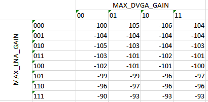

Hi, I'm using an Olimex development board with CC430 at 38.4k baud, 915MHz. In the CC430 user guide, it says that I must generate a similar table to the one in 25.3.3.6.4.1 with different MAX_DVGA_GAIN and MAX_LNA_GAIN values. I have been setting the AGCCTRL2 registers with different values and reading off the RSSI values when the radio is in RX mode. I got this table
Compared to the pattern of numbers in the user guide, this table is definitely incorrect. Can I please get a pointer on how to get the CS RSSI value correctly? Thanks.
This is my code for thus far. It runs on 1 device that is just sitting there by itself (without any other devices sending data)

#define	DEVICE_1
#define RSSI_SAMPLES		20
uint8_t RxBuffer[255], RxBufferLength = 0;
int16_t rssiValues[RSSI_SAMPLES];
int16_t rssiAvg = 0;
uint8_t rssiIdx = 0;
uint8_t max_dvga_gain = 0;
uint8_t max_lna_gain = 7;
uint8_t displayedAvg = 0;

	WriteSingleReg(AGCCTRL2, (max_dvga_gain << 6) | (max_lna_gain << 3) | 0x03);

			printf("MAX_DVGA_GAIN = %d\r\n", max_dvga_gain);
			printf("MAX_LNA_GAIN = %d\r\n", max_lna_gain);
			printf("AGCCTRL2 = "BYTETOBINARYPATTERN, BYTETOBINARY(ReadSingleReg(AGCCTRL2)));
			printf("\r\n%d dBm\r\n", rssiAvg);
