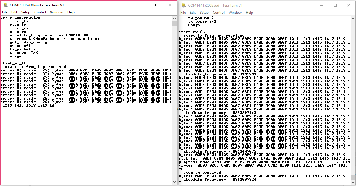

Attached is source code for a TI-RTOS based test platform that was built from RF easy link example that supports user interface through UART.
Steps involved
1. Get the latest TI-RTOS version. This software is built using version 2.14.2.22
2. Connect two SmartRF06 boards with CC13xx
3. Open the attached project (rfEasylinkTxRx_CC1310DK_TI_CC1310F128) in CCS. Build and download the code.
4. Open 2 UART terminals like coolterm, connect at 115200 baudrate.
5. Start typing in supported commands listed in rfEasyLinkTx_readme.txt file in the project and also listed below.
6. The errors, rssi, payload will be printed on the UART terminal also with the response to the commands.
UART - baudrate 115200; Enable local echo
COMMANDS
Note: All commands must be typed in lower case
1. absolute_frequency GMMMKKKHHH - Sets the Center frequency
2. absolute_frequency ? - Prints the value of the center frequency to UART
3. start_tx - Starts transmitting packets and prints payload
- Packet size and payload are defined in rfEasylinkTxRx.c as
- NUMBER_OF_PACKETS is 10
- PAYLOAD_LENGTH is 27
4. stop_tx - Stops Tx
5. start_rx - Starts receiving packets and prints RSSI and payload
6. stop_rx - Stops Rx
7. tx_power X - Sets Tx power in dB - X can be {14, 12, 11, 10, 9, 8, 7, 6, 5, 4, 3, 2, 1, 0, -10};
8. tx_power ? - Prints the current values of Tx power in dB
9. tx_datarate ? - Prints the current data rate in xxx.yy kbps
10. cw on - Enables CW mode
11. cw off - Disables CW mode
12. get_radio_config - Prints current radio setup
13. start_tx_fh - Starts TX in Frequency hopping mode. Use stop_tx to end transmission.
14. start_rx_fh - Starts RX in Frequency hopping mode. Use stop_rx to end receiving.
