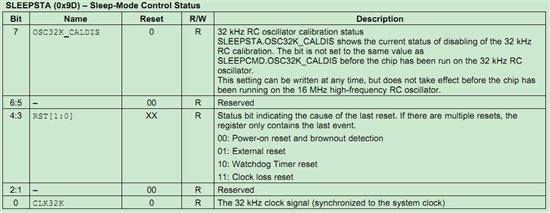

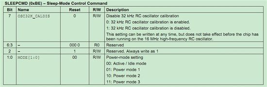

Some problems about the specification of SLEEPCMD/SLEEPSTA were found when I read the Basic RF programs.
1. In the User Guide of "CC253x System-on-Chip Solution for 2.4GHz IEEE802.15.4 and ZigBee® Applications", LiteratureNumber: SWRU191 April 2009,
there's a figure as below. And in programs of  the Basic RF, bits like OSC_PD, XOSC_STB, HFRC_STB are used.
However, none of such bits is specified in tables as below.
So the software program is inconsistent with the datasheet, isn't it? If so, which one is correct?
Thank you in advance, hec!
