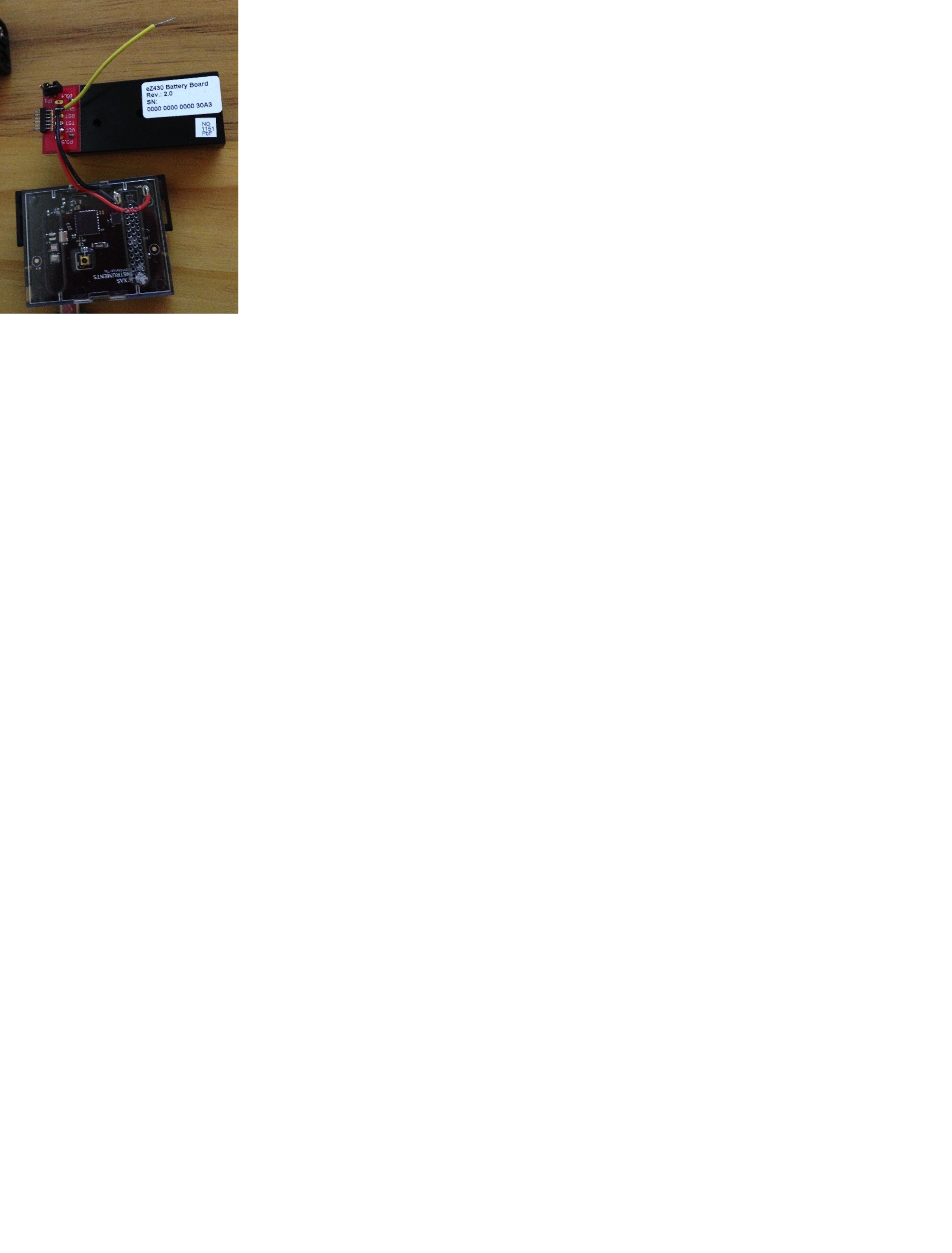

  • Hi Stefan,
    I am waiting for a Devpack-Solar to be available as well for that and other reasons.
    Currently I have an eZ430 Battery board soldered with 2 wires into sensortag.
    Remove the button battery and solder into 2 big pads marked B+ and B-
    Alternatively use any 2 x AAA battery holder.
    Hope this will help.
    Jan

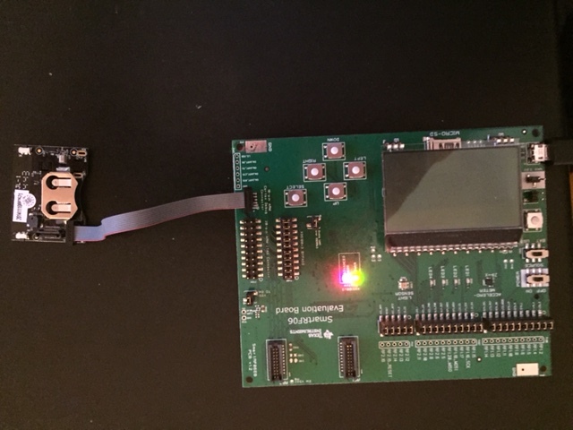

  • Thanks for the hint Jonas!
    I connected the SmartRF06EB as shown in the picture below.
    I succeded in reading out the memory content from the sensortag 2.
    I have also succeded in flashing the SmartRF06EB and reading out the data, setting the leds and so on using COAP.
    => The sample "cc26xx-web-demo" described here: processors.wiki.ti.com/.../Cc26xx_sw_examples
    => build with "make cc26xx-demo.bin" in "Instant Contiki"
    I have also succeded in compiling and flashing the the example above for the Sensortag2 using
    => "make BOARD=sensortag cc26xx-demo.bin"
    However, when flashing the "cc26xx-web-demo" sample to the sensortag 2, i get the verification error below.
    I have tried to compile a second time, but i always get a verification error at pag 17.
    And i did an "make clean" bevor compiling it... with "make BOARD=sensortag cc26xx-web-demo.bin"
    Any hints welcome! :-)
    Error when flashing cc26xx-web-demo.bin to the sensor tag 2 using "Smart RF Flash Programmer 2":

    >Verification failed at address 0x00011400 (in page 17). Expected 0x08, read 0x8C.
