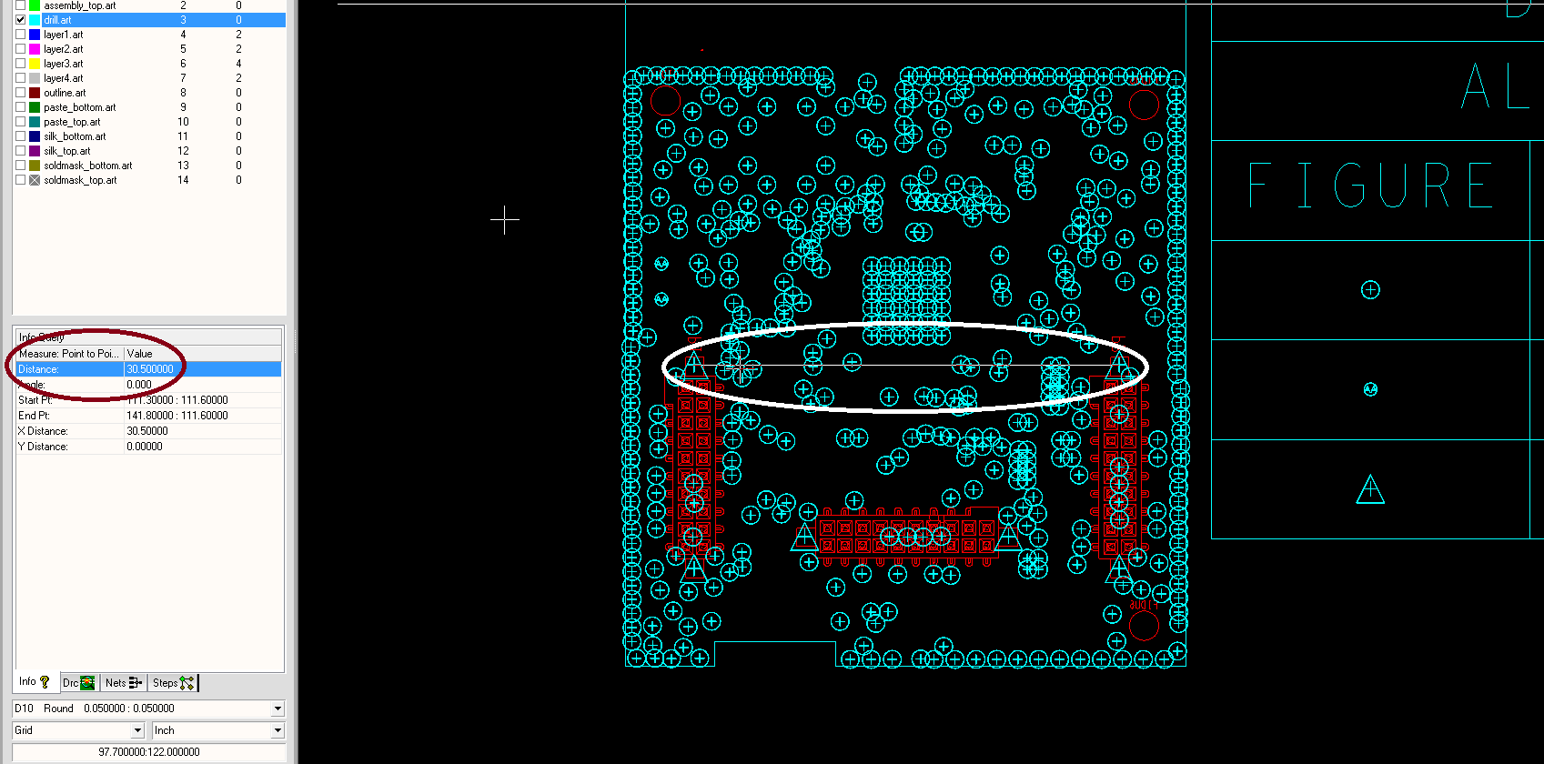

I'm looking to find information regarding the spacing required between the cc2538em connectors. I'm working on a prototype PCB and would like to be able to plug the Evaluation Module directly onto my board. Can someone point me in the right direction as to how to obtain and verify my spacing between the connectors are correct. I am using Eagle to design the board.
Thank you
    Attached is a screenshot from CC2538EM Gerbers I've imported to Altium designer and measured the distance between
    two drill holes that are used for directing these connectors in assembly (the distance is 30.5mm).
    Also I've exported the assembly_bot  and drill layers to a DXF, however I didn't check if it usable dxf.zip.
