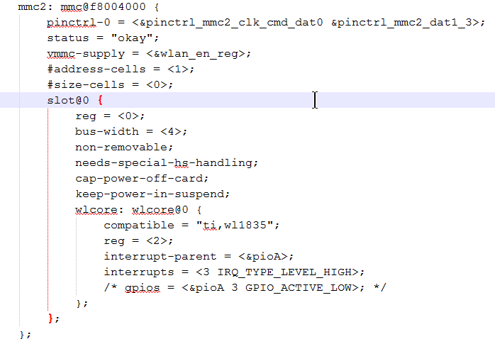

wl1271_sdio: probe of mmc2:0001:2 failed with error -12
Other Parts Discussed in Thread: WL1271, WL1835
What is the error below mean?

  • As it looks as though you have used R8.6 it is most likely to be a device tree problem. In R8.6 the device tree usage changed. Here is the patch for TI's AM335x DTS file. I suggest you make sure you have the same changes in your device tree file.
    git.ti.com/.../715fc23917f42891ce798a8beefc245fb440c6d2
    Iain
  • I am still getting the same error after applied changes to DT per your link. I also ran lsmod, notice only wlcore_sdio and compat module got loaded during startup.
    I can manually load the rest of the modules but wlan0 is not available when type "ifconfig -a"

    Can you attach the full boot logs?
    Also, which location are you putting the new dtb?
    Gigi Joseph.
  • Attached full log and device tree.
    dtb file location: /armv7_devel/KERNEL/arch/arm/boot/dts/

    			/* FLEX, support WL1835 Wlan*/
    			mmc2: mmc@f8004000 {
    				pinctrl-0 = <&pinctrl_mmc2_clk_cmd_dat0 &pinctrl_mmc2_dat1_3>;
    				status = "okay";
    				vmmc-supply = <&wlan_en_reg>;
    				#address-cells = <1>;
    				#size-cells = <0>;
    				slot@0 {
    					reg = <0>;
    					bus-width = <4>;
    					non-removable;
    					needs-special-hs-handling;
    					cap-power-off-card;
    					keep-power-in-suspend;
    					wlcore: wlcore@0 {
    						compatible = "ti,wlcore", "ti,wl1835";
    						/* interrupt-parent = <&pioA>; */
    						gpios = <&pioA 3 GPIO_ACTIVE_LOW>; /* Bank A, pin 3 connected to IRQ line of WL1835MOD */
    			/* Power Control using a Fixed Voltage Regulator */

    Your wlcore node should look like the below:
    wlcore: wlcore@0 {
    compatible = "ti,wl1835";
    reg = <2>;
    interrupt-parent = <&gpio3>;
    interrupts = <17 IRQ_TYPE_LEVEL_HIGH>;
    Gigi Joseph.
  • My follow your suggestion but same error. My changed below. Do you think "wlcore" node under "slot@0" node is correct? I am not confidence if it is but move anywhere outside of "slot@0" node, mmc2 doesn't see the device.
    New log attached.

    [    1.780000] atmel_mci f8004000.mmc: card claims to support voltages below defined range
    [    1.790000] mmc2: queuing unknown CIS tuple 0x91 (3 bytes)
    [    1.800000] mmc2: new high speed SDIO card at address 0001

    [ ok [    5.330000] Loading modules backported from Linux version R8.6-0-g3f5b34f
    [    5.330000] Backport generated by backports.git R8.6-0-g4677dc3
    [    5.360000] wl1271_sdio: probe of mmc2:0001:2 failed with error -12

    Yeah, I saw that example from HERE. I am using SAMA5D3_xplained from Atmel. Let me debug some more.
  • I've been trying to debug and many trials and either getting worst or same error. I don't know what else to do to get this working. Below is something I got when grep mmc of TI wl1835. What does it mean? Anything useful here?

  • Patch applied with same error "[    7.630000] wl1271_sdio: probe of mmc2:0001:2 failed with error -12". Attached log file.

  • You probably need to add some more debug messages in the source code of wlcore_sdio.ko to see where it fails.
    The relevant file is:
    Drivers/net/wireless/ti/wlcore/sdio.c
    Inside the compat-wireless directory.
    Start with the probe function and see where it fails.
  • I added some debug statements but "sdio.c" kept getting overwritten/updated by the original file under /build-utilities/src/compat_wireless/drivers/net/wireless/ti/wlcore/sdio.c.  I use "./sudo_build_wl18xx.sh" to build. How can I disable the update to source file?
  • Hi CHuong,
    You need to edit the copy of the driver in build-utilities/src/driver/drivers/net/wireless/ti
    when you do the build process it takes the base set of drivers from the src/driver directory and merges them with the src/backport directory for your kernel. The result of this process is that the src/compat-wireless directory is updated every time you build.
    Iain
  • I added additional debug messages and found "error -12"
    *****FAILED HERE*******************************************************************
    static int wlcore_probe_of(struct device *dev, int *irq,
                                struct wlcore_platdev_data *pdev_data)
             struct device_node *np = dev->of_node;
             if (!np || !of_match_node(wlcore_sdio_of_match_table, np))
                     return -ENODATA;
    *****FIXED HERE******************************************************************
    I follow this thread and able to fix the "error -12".
    *****LOG****************************************
    [ 6.990000] Loading modules backported from Linux version R8.6-0-g3f5b34f
    [ 6.990000] Backport generated by backports.git R8.6-0-g4677dc3
    [....] Waiting for /dev to be fully populated...[ 7.150000] cfg80211: Calling CRDA to update world regulatory domain
    [ 7.310000] wlcore: Time Sync: gpio requested
    [ 7.400000] cfg80211: World regulatory domain updated:
    [ 7.410000] cfg80211: DFS Master region: unset
