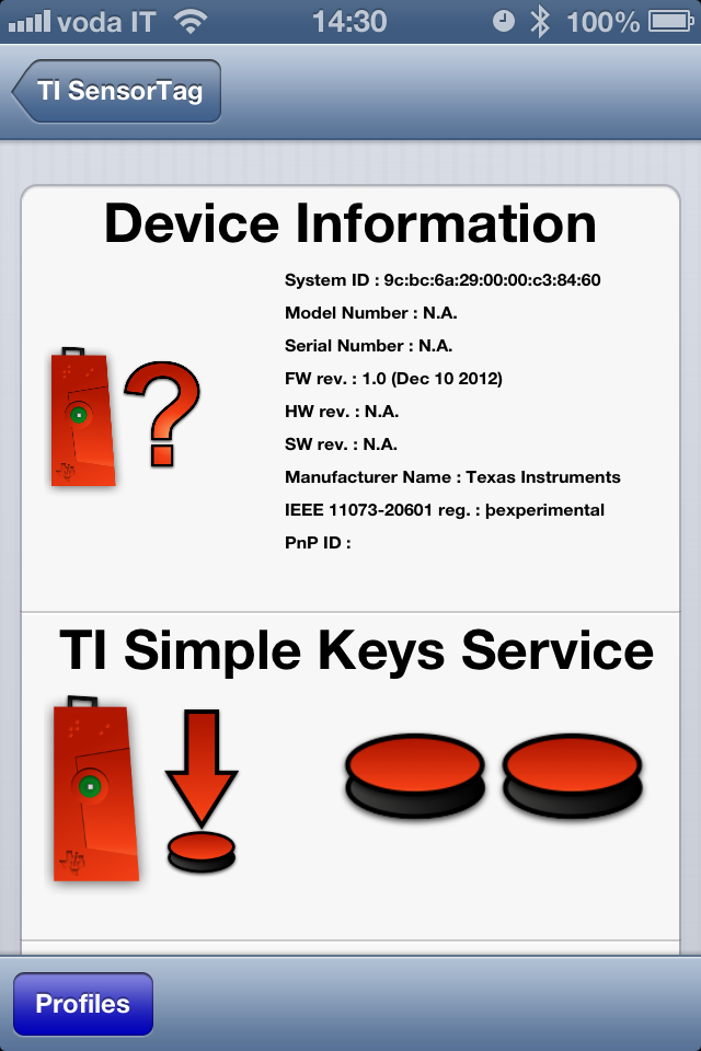

Hi all, i've started to play with my SensorTag but i'm having a lot of problems with it.
I'm working with the iOS app on a iPhone 4S and basically the sensortag randomly stops working.
It either:
- show up on the iOS app when i launch the app but the icon under the (X)/(V) sign is missing. i can connect to the device but when i open the app it says "no profiles or sensors enabled, click settings to configure device" and if i tap the "profiles" button at the bottom of the page the profiles tab is empty.
- initially work but the sensors quit working (this happens especially with the accelleration sensor) after a while (2/3 minutes) of running
- stop responding, the led stays dead when pressing the button and the tag doesn't show up in the app.
Resetting the bluetooth stack or rebooting the phone doesn't solve the problem, i have to pull the battery from the tag.
Any idea?

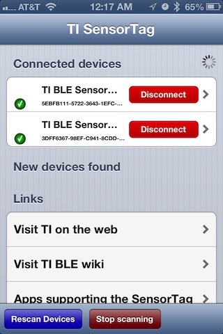

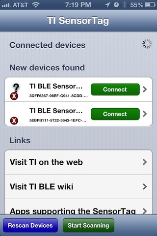

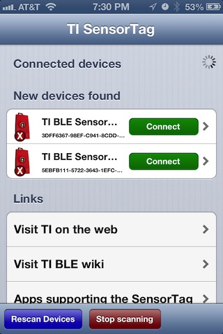

  • I received two SensorTags this afternoon and have had the "No profiles or sensors enabled" message from each of them, one at a time and both at once. Disconnecting the battery for several seconds seems to fix the problem, at least temporarily.  In addition to the "No profiles" message, I also noticed that the SensorTag icon that is normally to the left of "TI BLE SensorTag disappears.  In at least one instance, it has been replaced by a question mark icon:
    Normal operation prior to connection:
    Both devices failed, no SensorTag icon, one with question mark icon:
    Both devices failed, no SensorTag icon, no question mark icon:

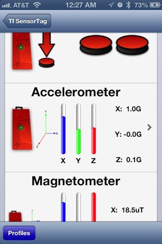

    Another thing I noticed is that the X and Y axes appear to be swapped for the accelerometer, at least relative to the axis diagram.  For instance, with the SensorTag sitting on its base (with the keychain tab uppermost), it displays +1.0 G for the X axis while the diagram implies it should be Y:
  • Hi David,
    We've seen this issues before and it's unfortunately a feature in iOS/core Bluetooth. We tried to find workarounds around this issue, but so far we haven't found a solution.
    The mitigation technique is to turn on and off Bluetooth on the iDevice.
    I agree that the accelerometer axis seems to have been swapped, we fix that with the next update , thanks for letting us know.
    BTW: instead of taking in and out the battery to reset the SensorTag you may push the side button for 5 seconds to do a reset.

    As far as the accelerometer axis issue goes, I think it is simply the icon being misleading. After a little more experimenting, I believe the axes are indeed correct if the SensorTag is placed on its long flat side (the one with the switch) as opposed to standing upright.  In that orientation, it shows -1.0 G for Y, as expected due to gravity.  The only thing that needs fixing is the icon in the app.
