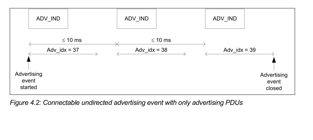

         Yes,  higher duty cycle of advertising event gives more chance for broadcasters  to be discovered. But it also means more RF conflicts becasue so many devices broadcast with a high fenquency on only three channels, right?
         If i tune the adv_interval to be 1000ms, there will be 33*3  time slots without any RF conflicts because an advertising event (RF transmit)will finish in 30ms(ch37 to ch39) according to BT Spec(P2224 of Core_V4.0 ).
         Then, if there are three scanner,each listens on fix channel (37,38,39), then maximum 99 broadcasters will be detected in one second  if no packet lost. correct me if anything wrong.
  • Hi Daniel,
    The parameters you are referring to are the maximum values. In our implementation, the three channels will be burst within 3ms. I recommend you have much smaller broadcast interval to overcome potential collision in the air.
